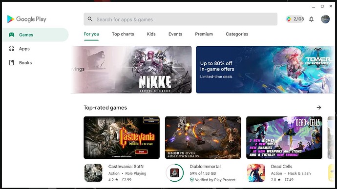

Android Container - Arch Hero
:tropical_drink::beer_mug: From OpenFyde version 108 We have Project ArcHero activated which mean that we can Install .apks Hurray! :raising_hands:
Now the good stuff about openFyde/FydeOS is that with ArcHero Android container we can play big time games from the app store:
  • Install apkpure, aptoide, uptodown, aurora store any store you like.
  • Install some some apks, xapk, apkm intallers like App Mirror, XAPK Installer, APK Installer.
    For big titles these installers are required. For general purpose.. apkpure is literally enough for most things.
The fun of being able to play this is amazing.
(dont mind the video stuttering its just that.. the video recording doesn’t do its justice it runs smooth).
You can now enjoy your hearthstone, diablo immortal, call of duty mobile etc.. etc.
There is however only one last thing missing for perfection but not even google ChromeOS made this work yet:
  • No gamepad support yet for the Android subsystem.
    There is #arc-input-overlay-beta - it can be turned on chrome://flags but what games supports it?

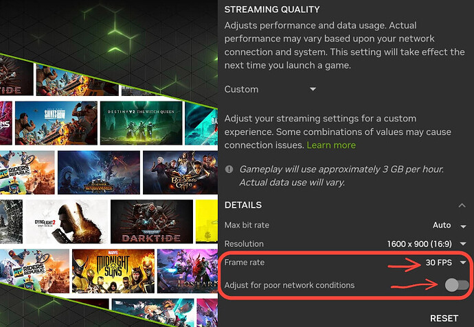

Install Vivaldi for Geforce Now and (Widevine DRM for Netflix couldn’t make it work if someone can please let me know.).
Vivaldi browser installation
  1. Download Vivaldi .deb here https://vivaldi.com/download/archive/?platform=linux
  2. Open GDebi and install your specific Vivaldi browser
Create a desktop launcher (‘Needed’ for GeForce Now and Widevine)
  • Info: This allows you to add browser start up lines to provide better performance. To let pages know you are at the latest version.
  • Command:
    /usr/bin/vivaldi-stable --disable-seccomp-filter-sandbox --user-agent="Mozilla/5.0 (X11; Linux aarch64) AppleWebKit/537.36 (KHTML, like Gecko) Chrome/110.0.0.0 Safari/537.36"
Same as openFyde Chromium for testing (Might improve performance- optional)
/usr/bin/vivaldi-stable --disable-seccomp-filter-sandbox --edge-touch-filtering --enable-native-gpu-memory-buffers --platform-disallows-chromeos-direct-video-decoder --enable-webgl-image-chromium --enable-features=Pepper3DImageChromium,UmaStorageDimensions,Crostini,CrostiniGpuSupport,SmartDim --num-raster-threads=2 --gpu-sandbox-failures-fatal=no --passive-listeners-default=true --enable-logging --log-level=1 --use-cras --enable-wayland-server --system-developer-mode --disable-mojo-broker --ash-use-cros-mojo-service-manager --cros-healthd-uses-service-manager --allow-os-install --login-profile=user --has-chromeos-keyboard --enable-touchview --disable-explicit-dma-fences --guest-wallpaper-large=/usr/share/chromeos-assets/wallpaper/guest_large.jpg --guest-wallpaper-small=/usr/share/chromeos-assets/wallpaper/guest_small.jpg --child-wallpaper-large=/usr/share/chromeos-assets/wallpaper/child_large.jpg --child-wallpaper-small=/usr/share/chromeos-assets/wallpaper/child_small.jpg --default-wallpaper-large=/usr/share/chromeos-assets/wallpaper/default_large.jpg --default-wallpaper-small=/usr/share/chromeos-assets/wallpaper/default_small.jpg --enable-consumer-kiosk --device-help-content-id=rock5b-openfyde --ozone-nnpalm-properties={} --arc-availability=installed --enterprise-enrollment-initial-modulus=15 --enterprise-enrollment-modulus-limit=19 --enable-crashpad --ml_service=enabled --ondevice_handwriting=use_rootfs --ondevice_document_scanner=use_rootfs --arc-start-mode=always-start-with-no-play-store --arc-availability=officially-supported --disable-features=ArcAndGuestOsFileTasksUseAppService,CrostiniUseDlc --disable-buffer-bw-compression --login-manager --feature-flags=["arc-game-mode@1","full-user-agent@1","ignore-gpu-blocklist","launcher-game-search@1","use-passthrough-command-decoder@1"] --first-exec-after-boot --enable-features=Pepper3DImageChromium,UmaStorageDimensions,Crostini,CrostiniGpuSupport,SmartDim --disable-features=ArcAndGuestOsFileTasksUseAppService,CrostiniUseDlc --flag-switches-begin --ignore-gpu-blocklist --enable-features=Pepper3DImageChromium,UmaStorageDimensions,Crostini,CrostiniGpuSupport,SmartDim,ArcGameModeFeature,DefaultPassthroughCommandDecoder,FullUserAgent,LauncherGameSearch --flag-switches-end --user-agent="Mozilla/5.0 (X11; Linux aarch64) AppleWebKit/537.36 (KHTML, like Gecko) Chrome/110.0.0.0 Safari/537.36"
Set the latest user agent or just your actual one: https://whatmyuseragent.com
Open Vivaldi with the DRM browser launcher and verify the parameters …
  • flags: vivaldi://flags Override software rendering list > Enable (Do it for performance!)
  • components: vivaldi://components (check if Widevine Content Decryption Module is loaded)
  • gpu: vivaldi://gpu
  • Just a side note about Mouse Cursor on Cloud Gaming on Vivaldi:
    All types of mouse issues will trigger you press Esc or Ctrl G the way to fix this is to keep pressing Esc a few seconds and going back into full screen mouse will go back into the game layout.

Access: GeForce NOW

Best tip to keep image steady without pixelation is to cut the gimmick crap by setting it to 30 FPS without Auto Adjust for Poor Network Conditions.
#Custom parameters just in case:
--user-agent="Mozilla/5.0 (X11; Linux aarch64) AppleWebKit/537.36 (KHTML, like Gecko) Chrome/110.0.0.0 Safari/537.36" --accept-lang=en-US
You can now enjoy playing games on Geforce now with an huge quality like a champ! Finally.

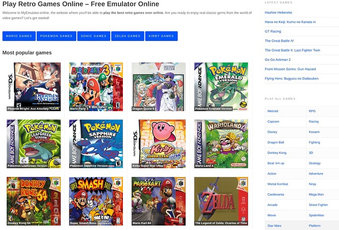

Fan of Retro and Old Classic Games?! Try My Emulator Online
Installing the Google Store is easy!
Run GApps installation stucks at 20% for a long while but you can see the log showing information rolling.
