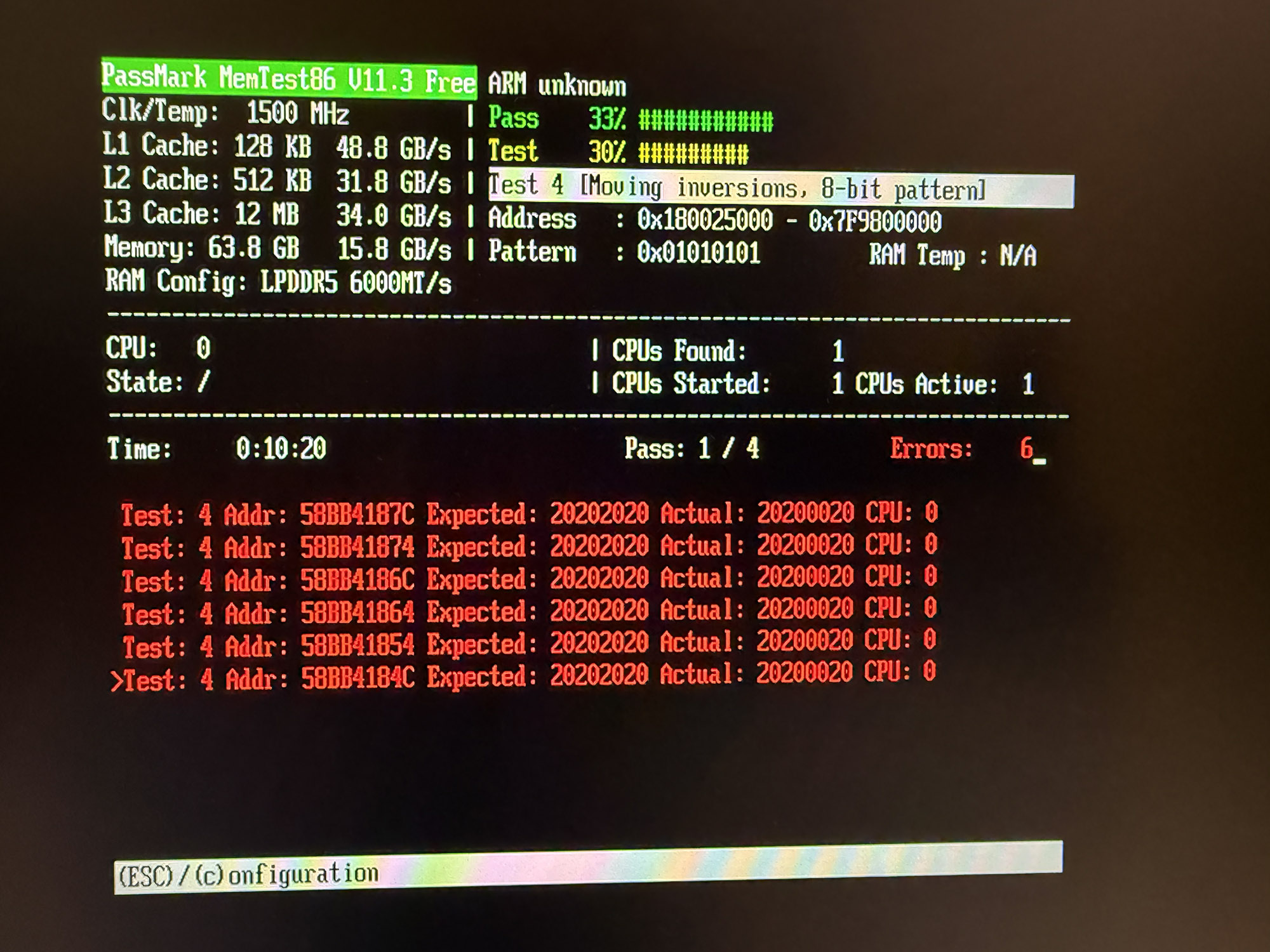

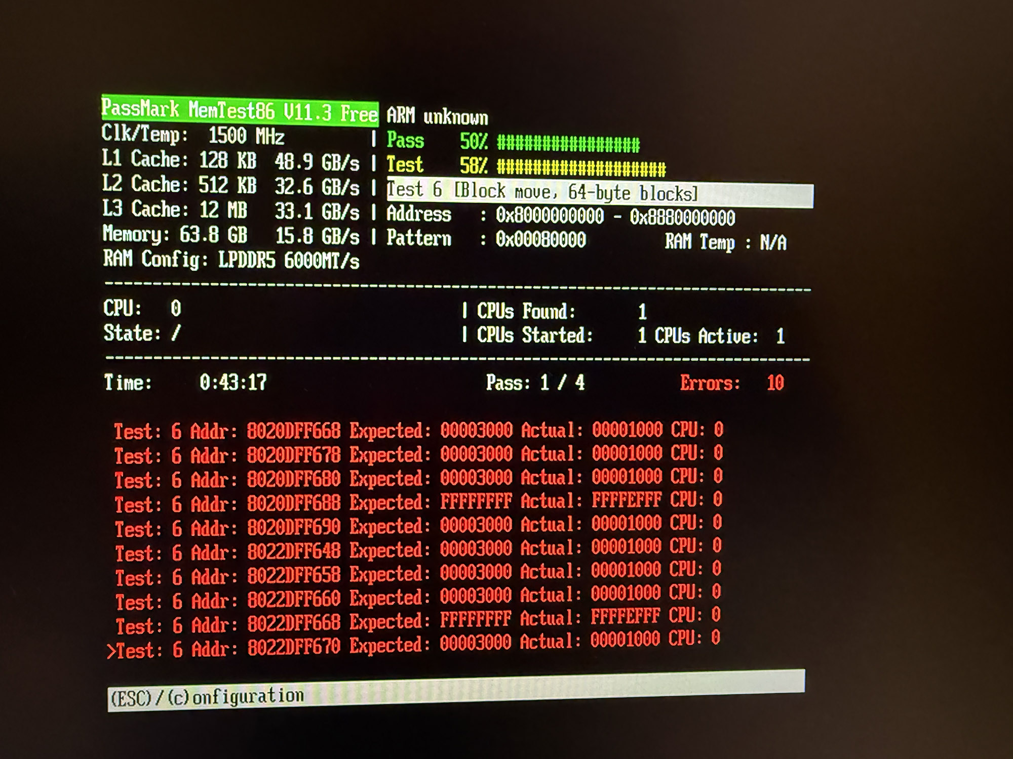

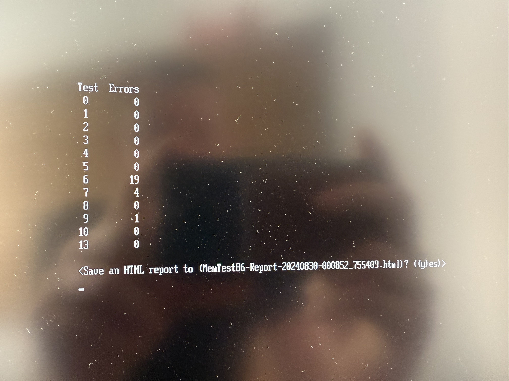

Also, memory test shows errors (photo attached).
Any ideas what else I could try? Feels like I’ve tested everything…
I saw something like that on one of my nucs, I needed to put heatsink and fan near memory, since then it works stable. No memory replacement was needed, just proper cooling. Try same thing - put fan near memory chips and retry test.
It could be a good indication that the problem is indeed there but it should not happen when the device is used under standard conditions. I think that the test would indeed help locate the problem but it looks like an RMA is going to happen. Also we don’t know the root cause. For example if the voltage regulator delivers insufficient voltage for RAM to be stable, such things could happen as well, without the RAM itself being bad. And when such a defect happens you never know how it will evolve over time.

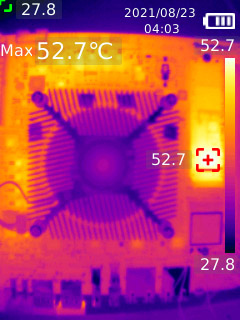

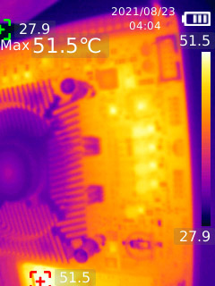

Temps seem fine — memory chips are pretty cool, but I still stuck on some small heatsinks just in case. The SSD is the warmest part, sitting at around 52°C.
Power draw during the memory test is about 17W, so nothing crazy there.

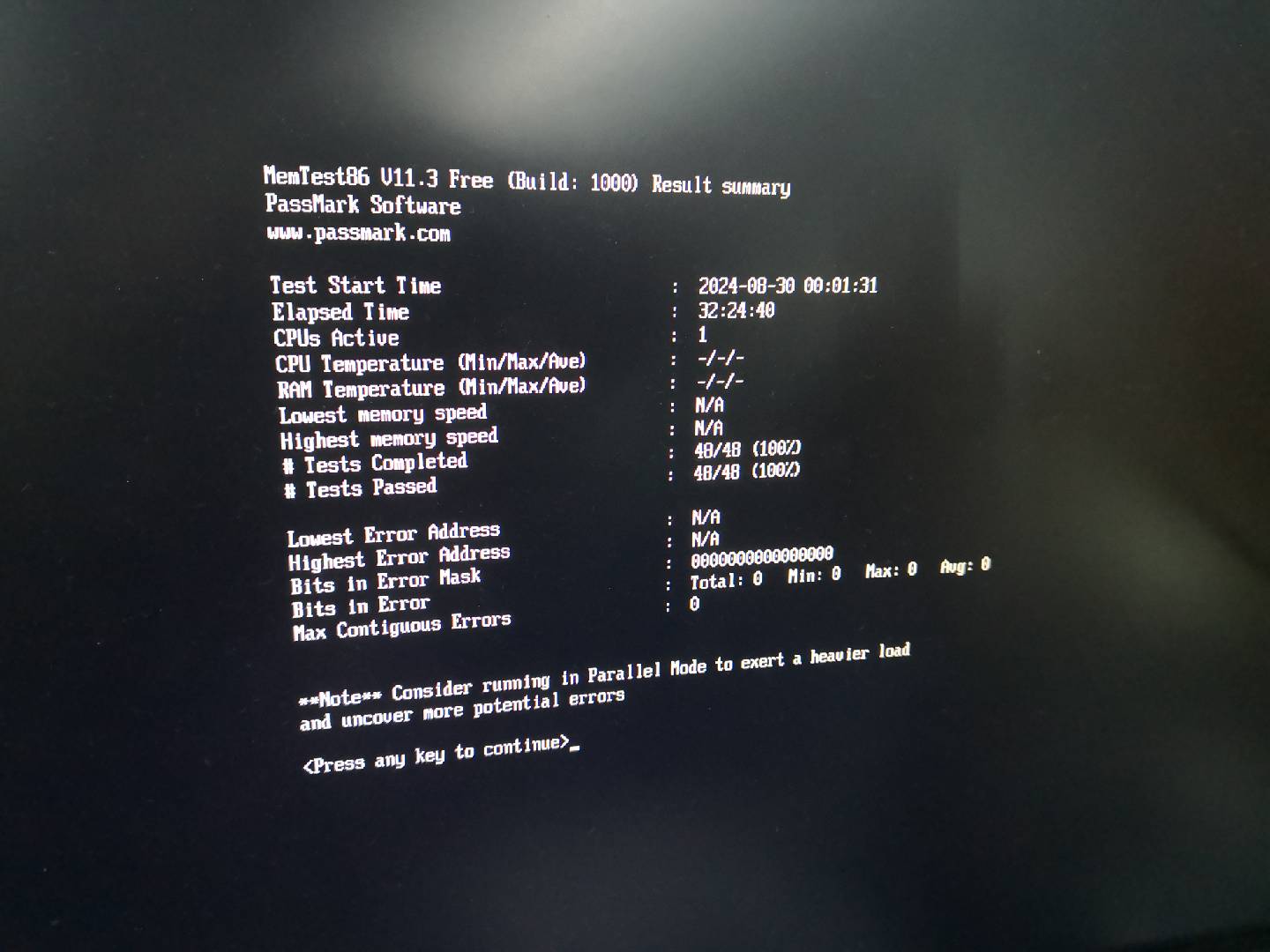

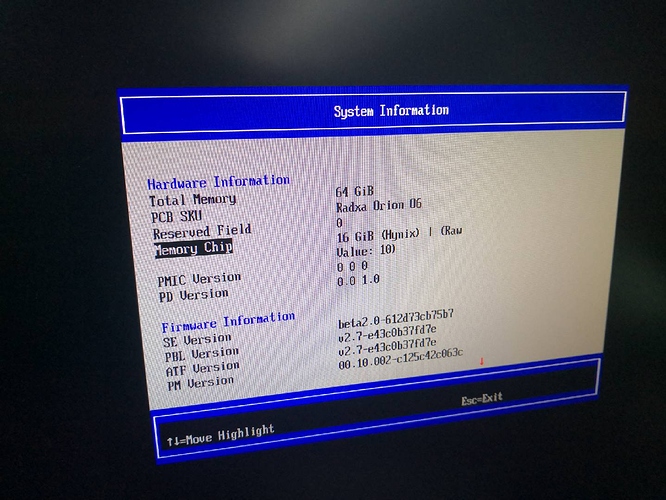

After some internal confirmation, we have reduced the clock for all Hynix 16GB variant to 5500MT/s, which was what pre-0.3.0 BIOS was using. Your board has been stable at this clock when running MemTest86.
Let me know if you are satisfied with this, so we can prepare the package for you.
Crush from ARACE just got back to me — he said they haven’t received my board yet, so it’s likely the one you’ve analyzed wasn’t mine. Please get in touch with ARACE to double-check.
I had the same problem. I spent 2 days trying different version and options of bios and different debian distro. I fixed using 0.3 bios version and minimal net linux distro found in this guide:
https://docs.radxa.com/en/orion/o6/bios/boot-debian-official-iso
To install debian official you need a usb network card because the minimal distribution doesn’t reconize Orion ethernet or wifi module. After the installation, the only way to install wifi module driver is compiling from source (I found a version compatible with debian kernel 6.1) on github
Arace has provided the machine to me, and I have ran memtest86 over the weekend on 5500MT/s BIOS, and did not produce any error. When I booted the device I saw 0.2.2 BIOS being used, and that one should not have the issue either. Did you reflash the BIOS before sending it back, or this is yet again from somebody else?
MemTest86-Report-20240830-000131_596661.zip (2.9 KB)
