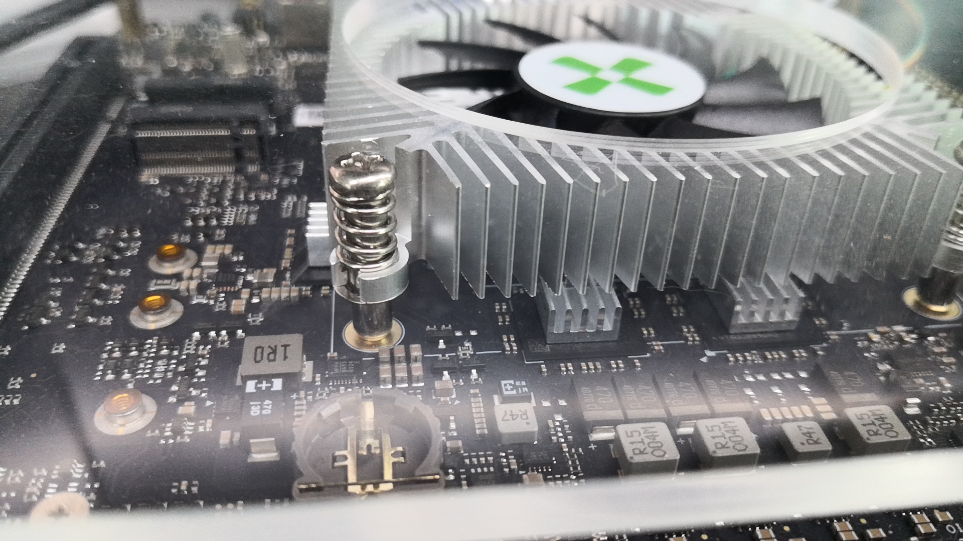

It appears to be yours.
Anything else you want me to test?
