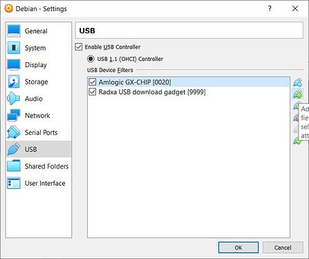

Install Debian on VirtualBox (before install make shure you set option Bridged adapter for Adapter 1 This will give you direct IP of Debian SSH) When on installing process create user pol. All commands path are with pol name in (ex. /home/pol/fip/radxa-zero/).
Use any instruction if needed ex. video

apt install fastboot
apt-get install -y python3-pip
pip3 install git+https://github.com/superna9999/pyamlboot

This are devices that should be redirected from Windows to VirtualBox on next steps so Debian could find radxa zero board and flash the bootloader (otherwise you will get errors):
reboot board and press USB button (add Amilogic GX-CHIP to VirtualBox)

reboot board and press USB button once more (Amilogic GX-CHIP to VirtualBox should be added)

make shure board gets in fastboot mode and host see it (add Radxa USB download gadget to VirtualBox)
