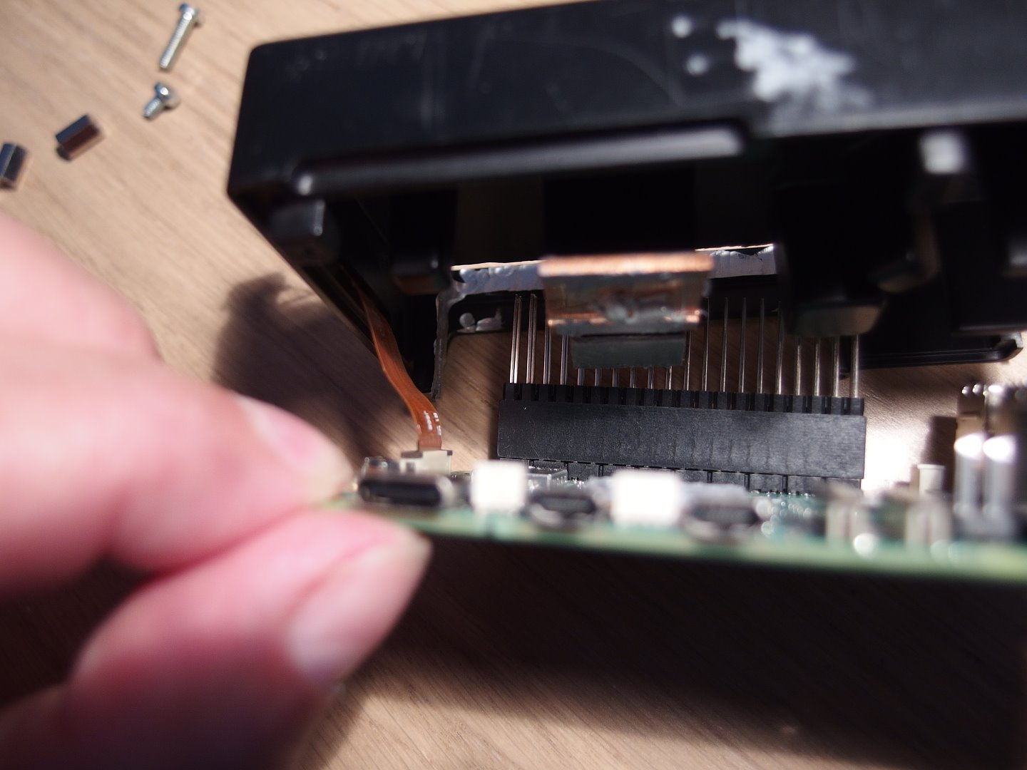

The new Pi5 offers PCIe and this is a good opportunity to create a fall back system and to check if measuring HDD temps without waken up the HDD is possible and with that to skip the external temperature sensors I used in the Pi4b setup The Heat issue solved by separating SATA HAT and Pi, now running close to four years.

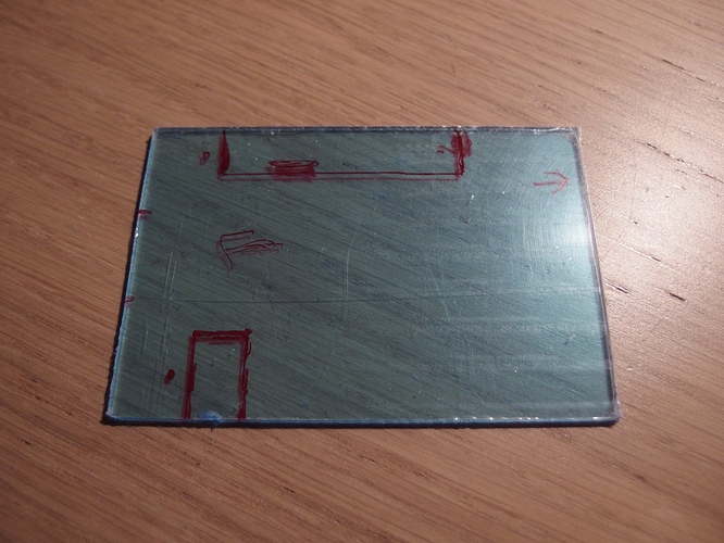

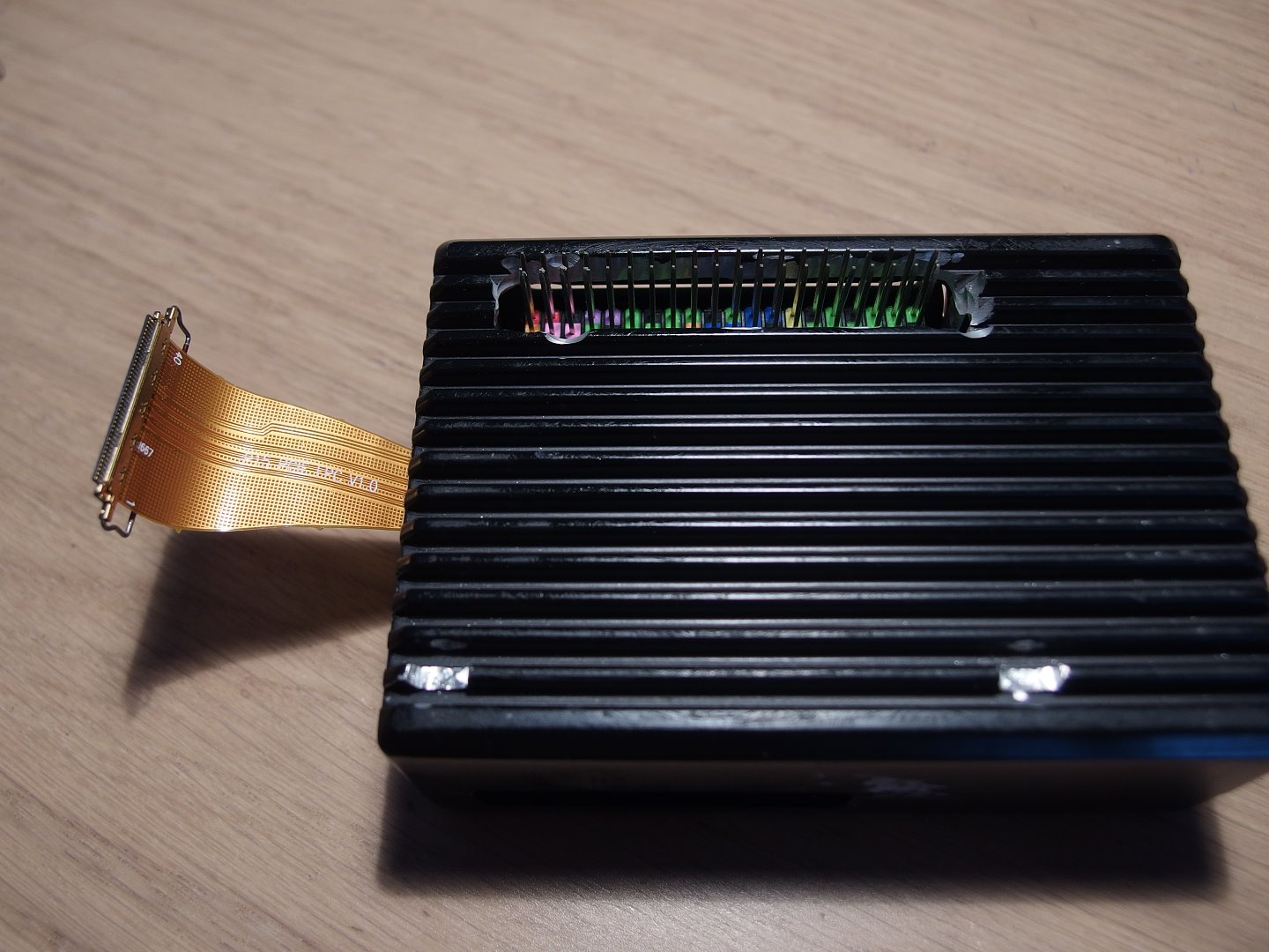

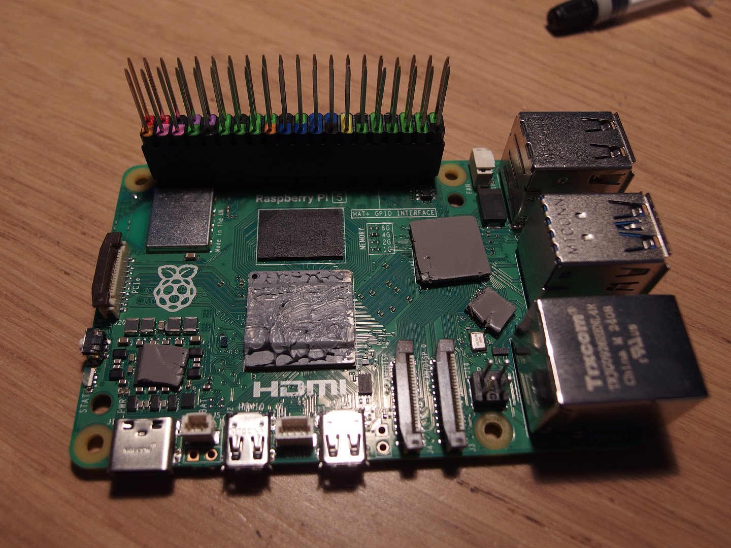

The first idea was to adopt the design, but that would imply a PCIe extended FFC cable in the front which would not look very appealing. So I remember that in the beginning of the Pi4b setup I already tested an option with a „40 Pin GPIO Stacking Header für Raspberry Pi, farbig kodiert, 13,3mm“ with a slot cut into the aluminium case.

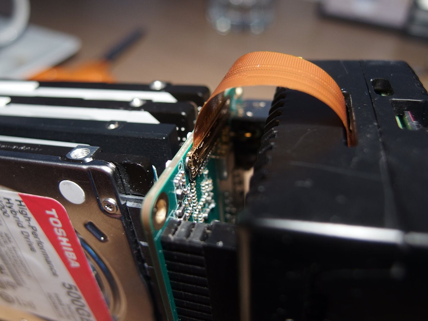

This basically worked out, but the USB3 cables I used at that time where very strong and not good bending for a small loop in back of the Pi, with them there was no option for a very short radius. Bridging the only few centimeters between Pi4b and the lifted HAT with bigger loops in the back did not look very appealing.
Today I know that I should have used the USB3 cables that come with the USB enclosures for external hard drives, as they are very thin and flexible and allow for much smaller loops.

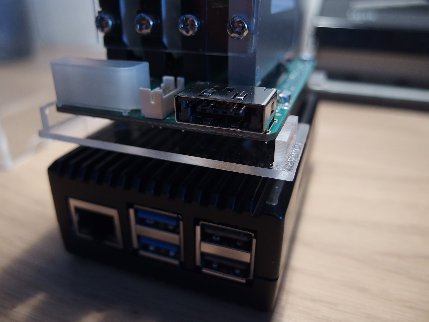

But now on Pi5 and with Penta Hat’s short PCie/IPEX cable the stacking solution seemed to be a good approach.
Overall the wiring and the software adoptions I did are quite analogue to the ones described in the Pi4b post.

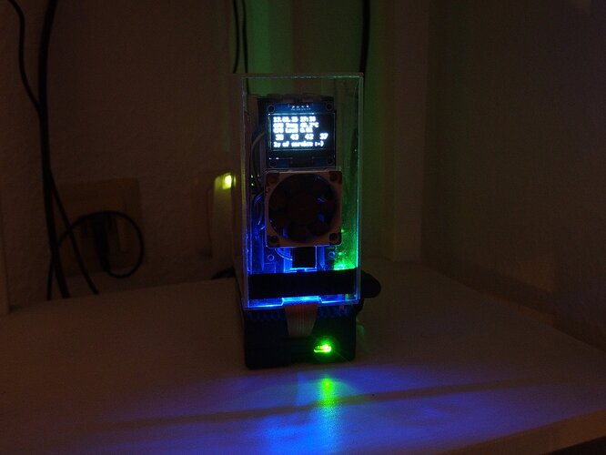

let’s rock :slight_smile:
now taking over service from the pi4 system after its 4 years of service

… just some impressions from the construction phase
one year of service
flawless operations :slight_smile:

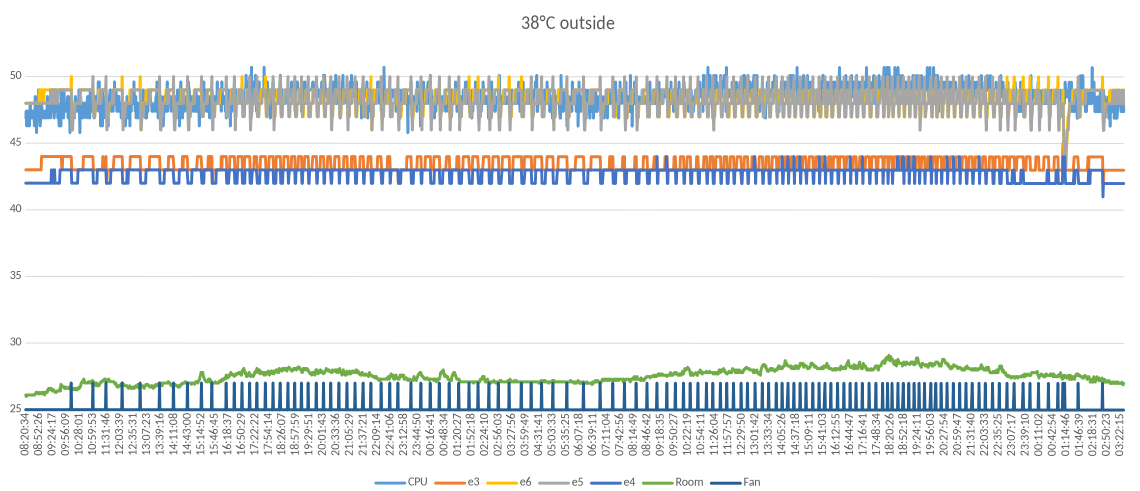

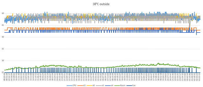

38°C outside
For Germany we faced a for June very uncommon temperature peak.
Usually the room temperature (green) is about 21.
The whole year so far and even on an outside of 30 the fan (blue spikes at bottom) does not need to spin to cool down SSDs to 50 (yellow and gray).
Now he was in duty cycle up to every 15 minutes.
Interestingly the HDDs (dark blue, orange) kept below trigger of 45 and
the passive cooled CPU (light blue) did also not exceed 52 - an optimal temperature.
