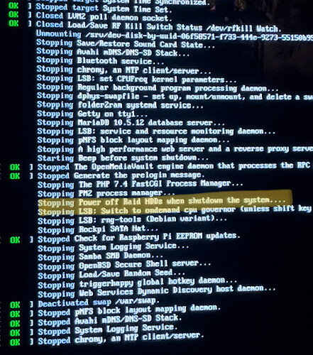

So actually I have three questions:
- Why aren’t the HDDs been powered off automatically (by the rockpi-sata.service) when the RPi is shutdown?
- How can I can I make it work to poweroff the HDDs when shutdown the RPi - the service is obviously stopped properly (see picture below)?
- Is there a way to show the
echolines from above in the shutdown list (see picture below)?
