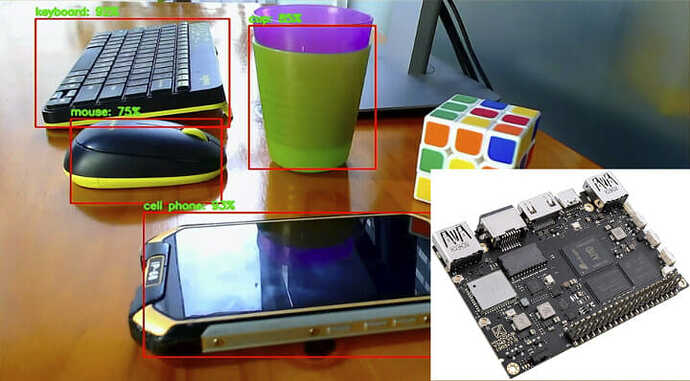

The CSI camera connector that was absent with the zero is on the 2 and its also got a pretty awesome 5 tops NPU.

With that being said, there is currently no mainline support on CSI or NPU (DSI pending). So it is most likely only available in Android with Amlogic kernel.
I don’t think the NPU is much to do with mainline support or will be as its sort of blocked due to licensing.
Khadas have a NPU toolkit for the Vim3 that runs on both Linux and Android but due to licensing it requires an individual sign up.
I have no idea what the current situation is so that just leaves CSI.
Again using Khadas as a reference they support a single camera so guess its possible but its not in the meson support list.
Android is still pretty cool for many and guess its all down to which version the biggest thing in Android 12 for me is offline voice recognition but I think Google has kept that for Pixel phones only.
I think the NPU is still in the same boat with licensing requirements.

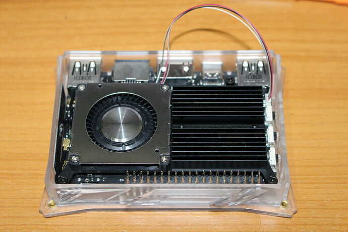

Does the A311D run a lot hotter than the S905Y2? If so, will the upcoming Radxa Zero 2 have the CPU moved to the underside of the board such that a full board sized passive heat sink can be fitted to it, as for the nicely fitted heat sink for your Rock Pi 4 series?
I was asking that as there is so much less pcb which often helps dissipate heat. I was asking if not being able to underclock as freq is fixed is a problem and apparently not so “If a proper heatsink is used” didn’t ask what a proper heatsink was but not a fan of underside CPU’s purely to simple convection and often the oversized heatsink needs.
I often felt with the Rock4 most of us where using it upside down but if you look at https://wiki.radxa.com/Zero2/Hardware/Revisions then there is no mention and the info we have looks like its top side with a dedicated gpio for fan speed and guess its own voltage regulator or pwm output.

Here you can find the product picture. The taped 3-pin connector is for a small PWM fan to use along with a custom heatsink.
Its a slightly fatter Zero by the looks of it but looking very cool.
