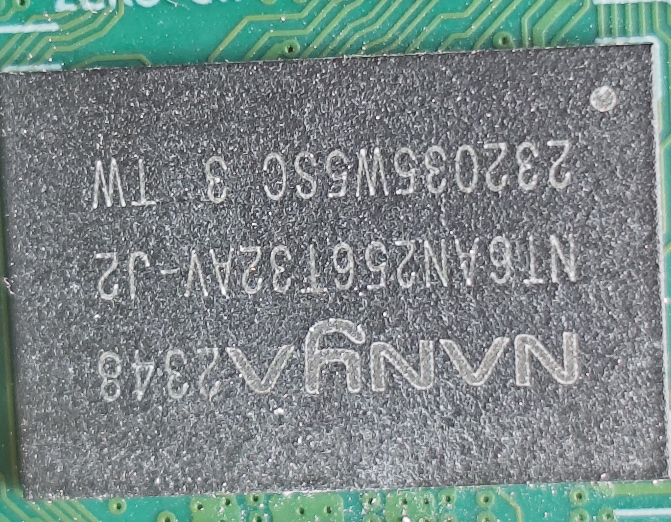

If possible could you provide a picture of the DRAM used on the board?
Sure, Its a NANYA Chip.
Markings:
NANYA 2348
NT6AN256T32AV-J2
232035W5SC 3 TW

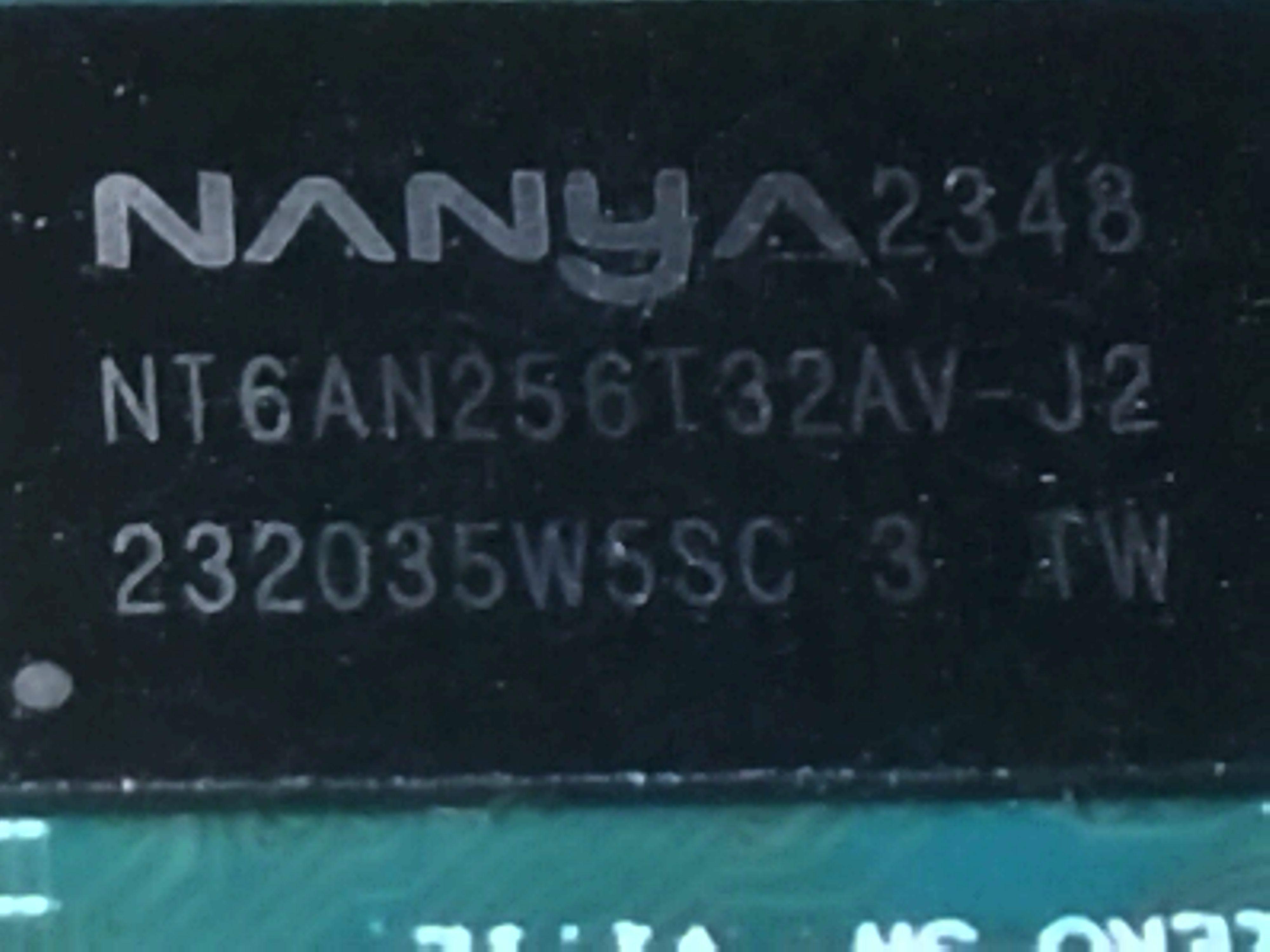

Same issue here with a new unit but pressing the memory chip does not work in my case. Cannot do anything. Have 3 others that work fine.
Exactly the same chip used
Model RS107-D1E8H1W15
Rev V1.122
SN:24410049-82P8QR
Warranty claim the product. There is no other solution.
