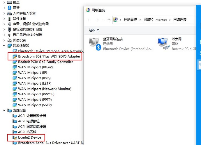

I have readed the following Topic and installed the driver in the zip file Z83-4_CherryTrail-T3-64bit_drivers.zip. Unfortunately,it does not work on my board. Windows 10 Pro last build 20H2

broadcom 802.11ac wdi sdio adapter and bcmfn2 device were both unable to start as in your earlier post
found the answer here:
the solution - copy the 4345r6nvram.txt file to C:\Windows\System32\drivers
After I did that and rebooted, the wifi worked.
hope this helps many who faced the same problem
