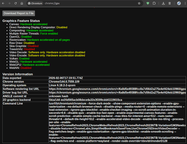

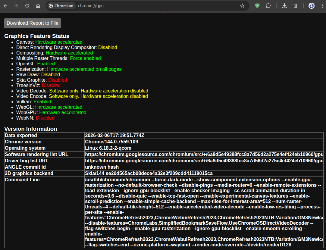

I installed a fresh build of RadxaOS R1, and when I launch Chromium, I see that hardware decoding is not active. Is there a way to fix this?
