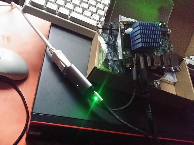

Hello,
I have a Type C To HDMI Adapter, which works with my phone, but doesn’t work with Rock 5B.
Neither HDMI nor USB port work.
