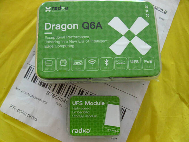

Hey! What’s fun with Radxa is that I really learn about new models when opening my mailbox after I get back from work :slight_smile: It’s always a bit like Xmas before the date. I first thought it was the components I ordered from Ali that arrived early, until I unpacked everything and stumbled on this:

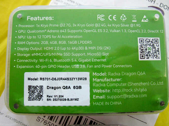

The specs are written on the back:
BTW it’s strange that it’s written ā€œ6GBā€ on the model while valid ones are 2/4/8/16. Probably that it’s 16 and the 1 wasn’t printed. I’m afraid I’ll have to wait a bit before testing it, I’m quite busy at the moment and next week is kernel recipes. Will probably check on the next week-end. Thanks to the team!

Hmm at first I was a bit confused by the ā€œ16 bitā€ width mentioned above. I checked the schematic, and it’s a dual-channel 16b (thus 32 total). I couldn’t find any reference for the marking on the board (CG439005200A0). I could imagine it would be a 6400 MT/s since it’s what the SoC supports. But indeed, if yours detects 6GB, that should be it. It’s just surprising since not listed on the list of optional sizes on the box. Maybe that’s the size chosen for the early models.
Edit: the spec here mentions ā€œ4GB / 6GB / 8GB / 12GB / 16GBā€ as the DRAM options, so it’s just the printing on the box’s bottom that’s not up to date.
The 6GB and 12GB model was added later when we found that at this size it would be a price/volume sweet point. The dram is running at 5500MT/s at the moment.
