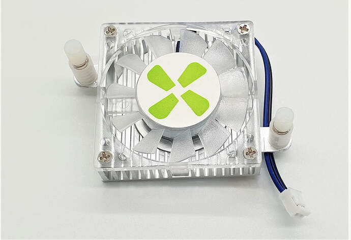

I just have a question regarding that box which looks perfect… is does the fan cooler fits in it?
If it does perfect.
there are not fan mounts in the case, if the fan is mounted to the heatsink, it depends on the overall size. If you have a heatsink with a mounted fan, would you please so kind to measure the high from the PCB?
Its not massive and I think it could be perfect inside the box if only u gave some slightly few holes on the top of it the case would be perfect.

The case is internally mostly empty, so the Top cover is ~18mm above the PCB, in the Video it looks like the fan is lower than the HDMI Connectors. The Cooler with the fan then will fit.
Radxa does not provide some measurements for the cooler with fan on there website.

And I’m waiting for the second order, there is a fan included, but it will take some time, then I can check and confirm the fan usage.

Fan fits perfectly into the case.
