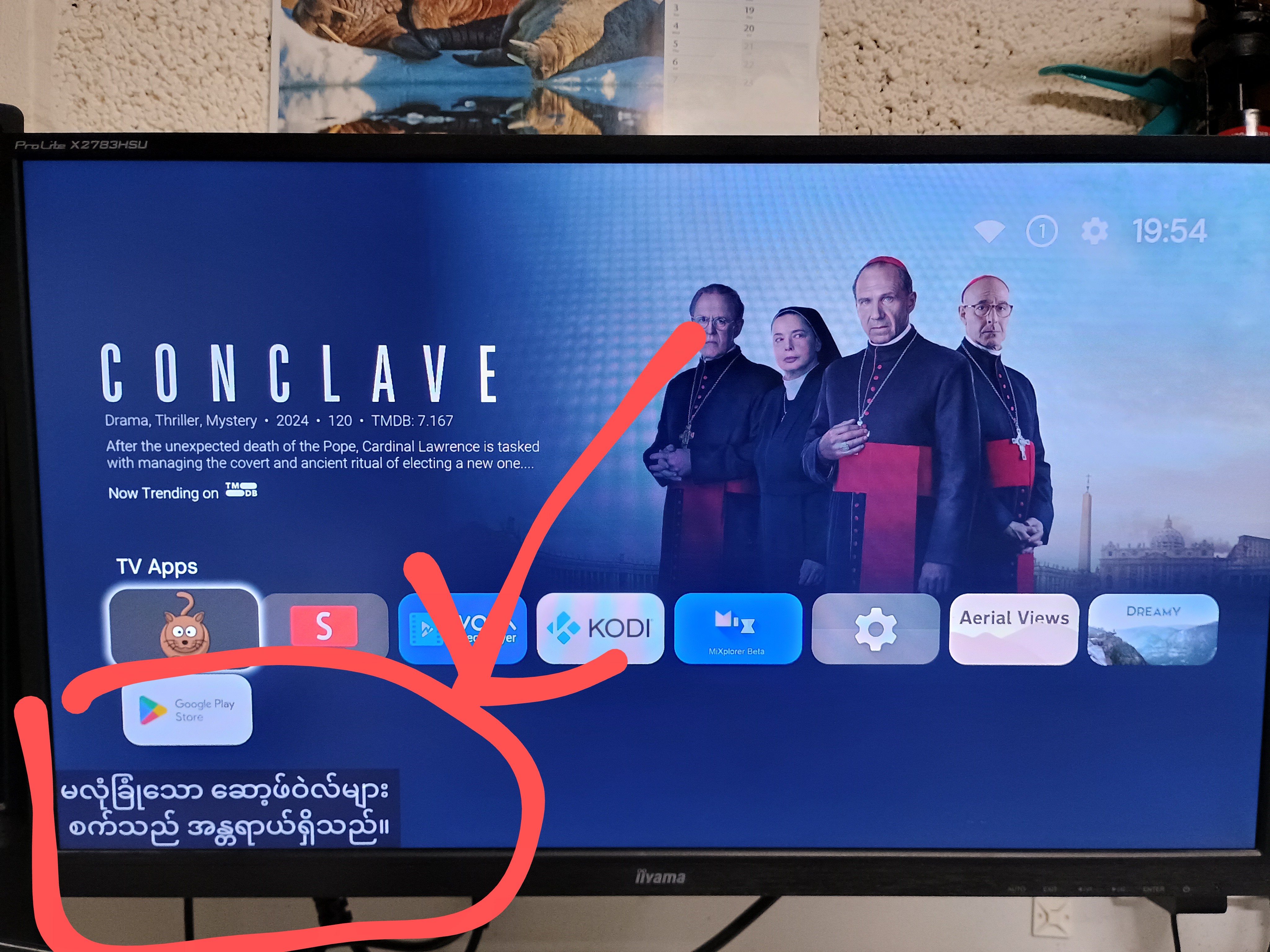

Getting a warning in Burmese at the bottom of the screen with the new image
Unsafe software puts the device at risk.
How do you remove this? as it’s always on
Tried Google and turning off play protect
But it won’t stay off
And also rooting didn’t remove it
Hi, in the image it like like it’s Srilankan language… Why in the world it is appearing there on the main screen? Did you install any special software ??

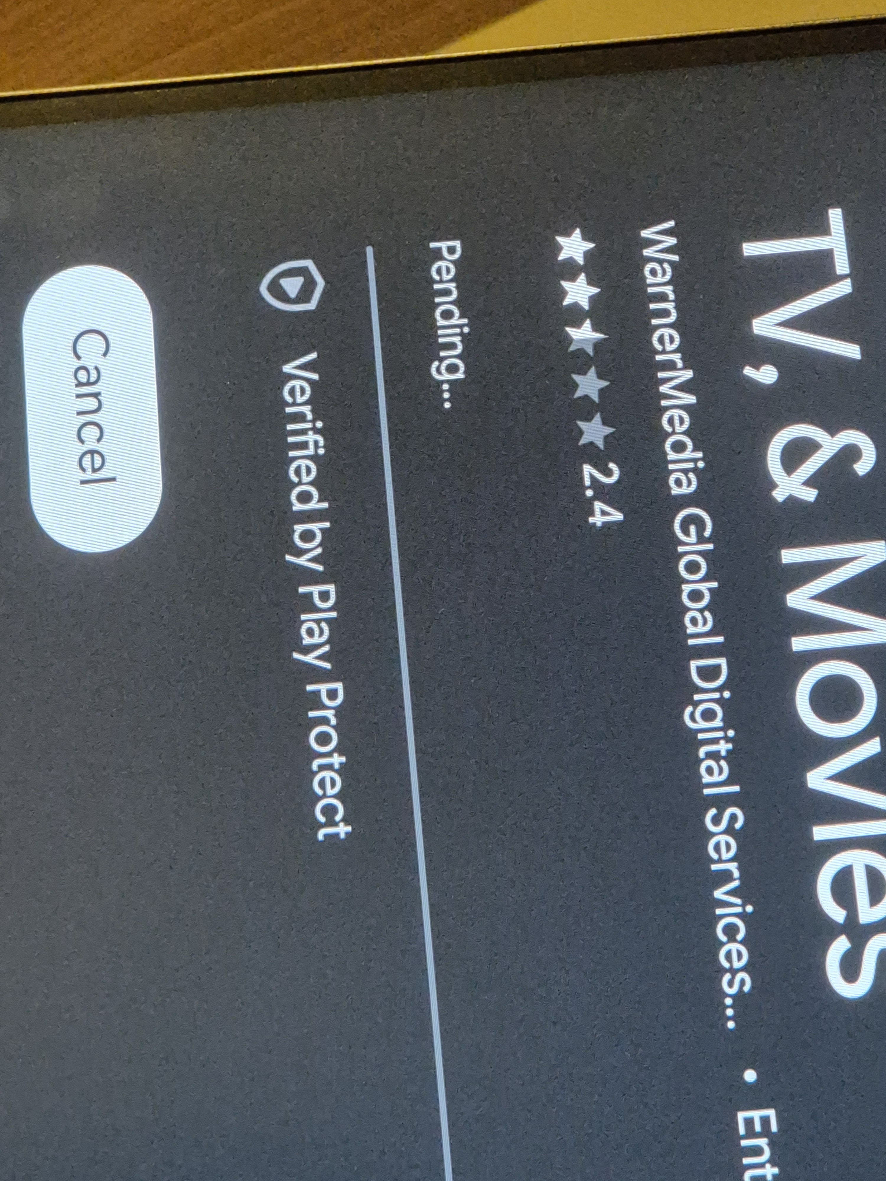

rock 5b, cant download apps from play store (stuck pending). Anyone know how to fix this?
