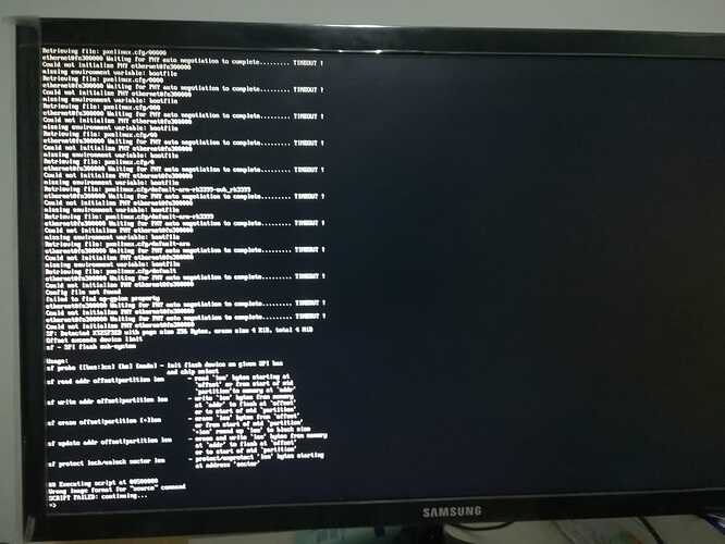

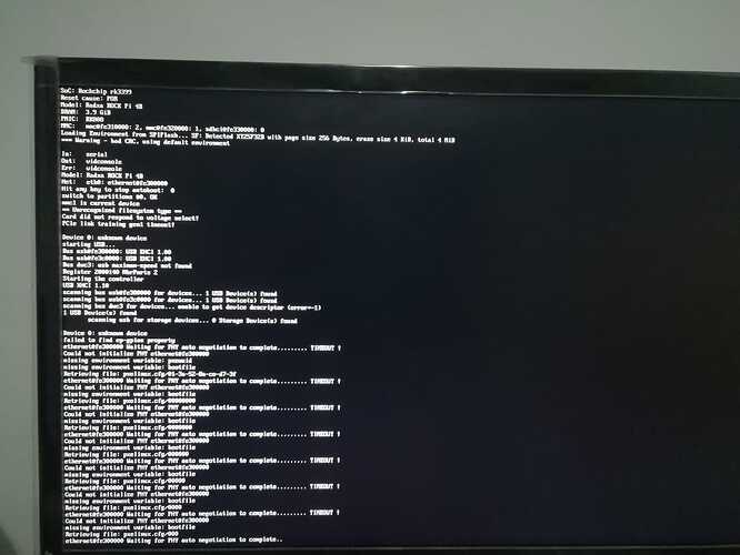

Hi guys, greetings how are you? I’m writing you cause I need help about Android TV on rock pi 4B, I don’t have eMMC and I’m trying to run it in a microSD card but it doesn’t boot/run Android, just stop in boot windows. I need a eMMC for Android or Can I run it with a microSD card?
Everything else run smooth like Lakks, debian, ubuntu, etc.
Thanks
Hi guys, anyone knows is this boot problem is cause the SPI Flash? I’m trying to run this Android TV directly from a MicroSD card, but it didn’t work, I attach a boot’s picture…
Thank you
