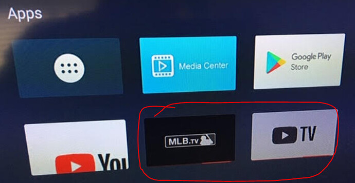

I have installed the new Android TV : rockpi-4b-pie-20190416_0936_f10ef3c-gpt
I'm trying to install YouTube TV ? Can't find it in the Play Store?
Also when attempting to UPDATE installed apps seems to be stuck downloading?
EDIT: I did find it finally - however all apps that I try to install or update just seem to be stuck or in progress - downloading?
Hi,
I had the same Problem.
At the end i used this image:
https://forum.radxa.com/t/rom-android7-1-android-tv-firmware-released/590
greetings
