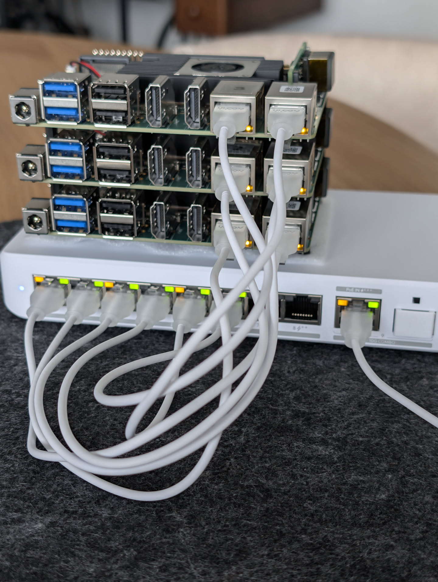

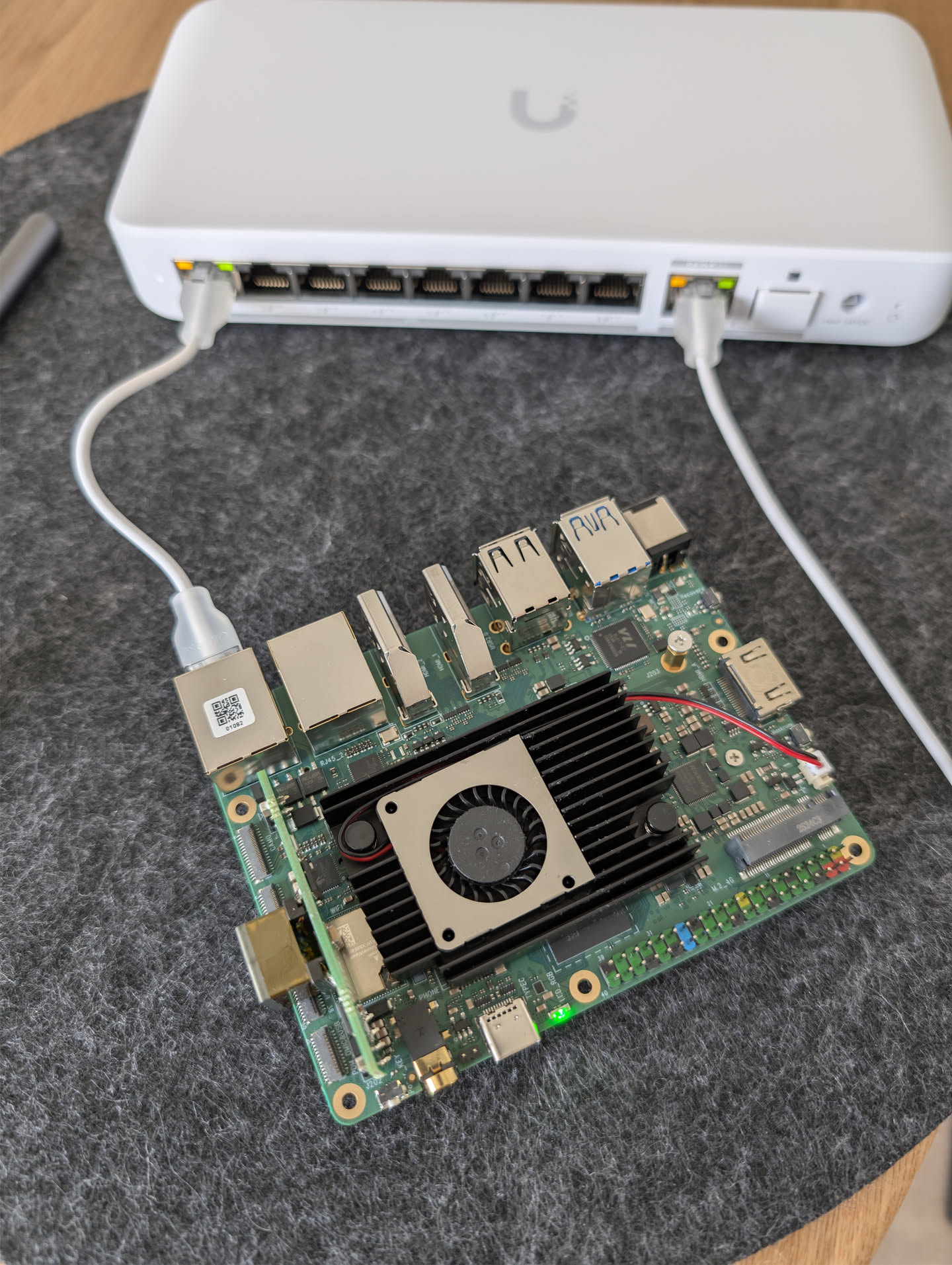

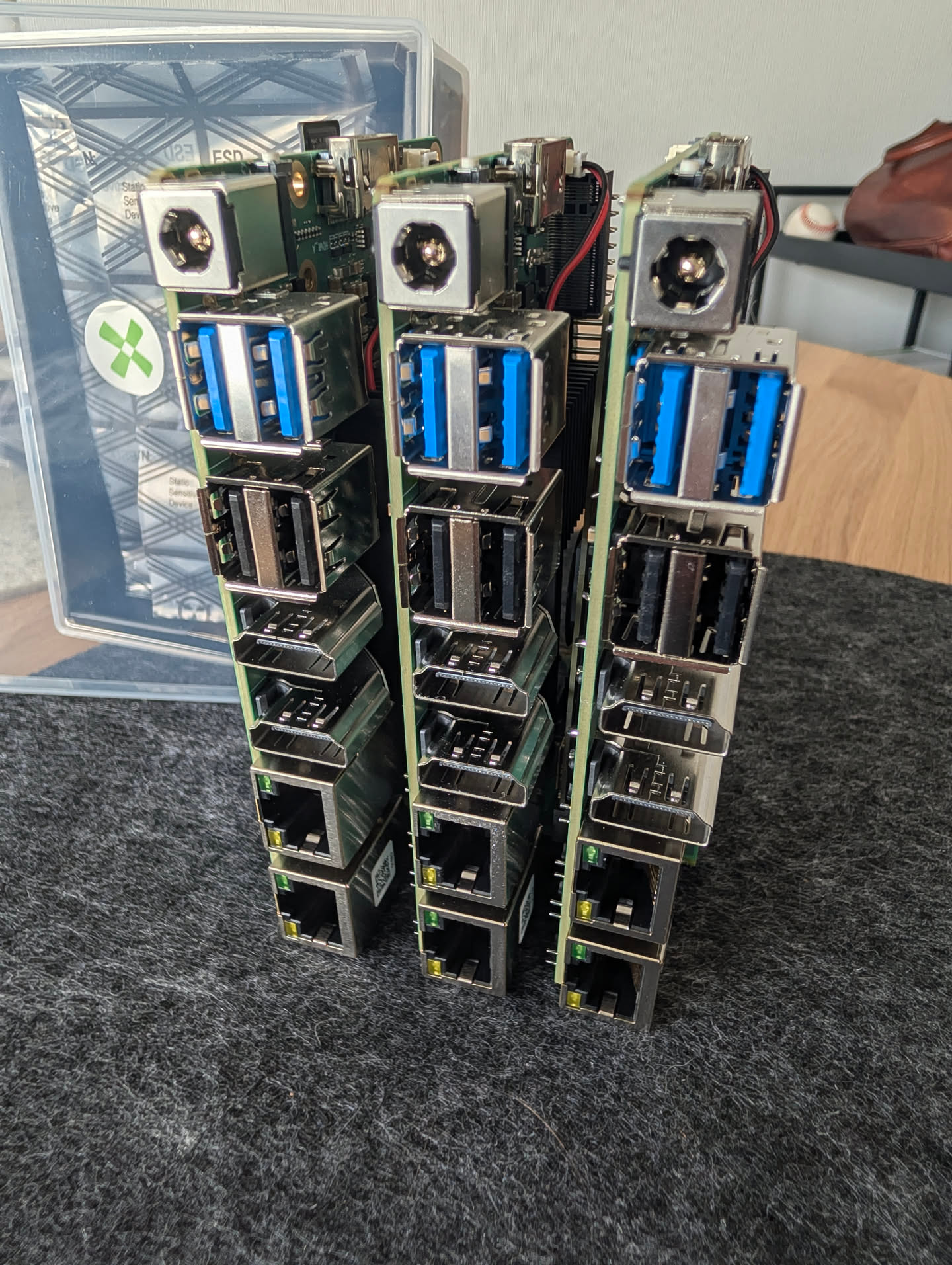

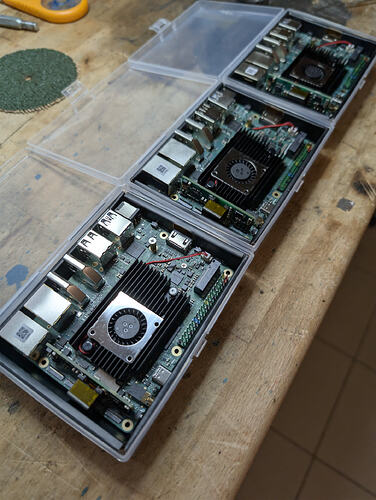

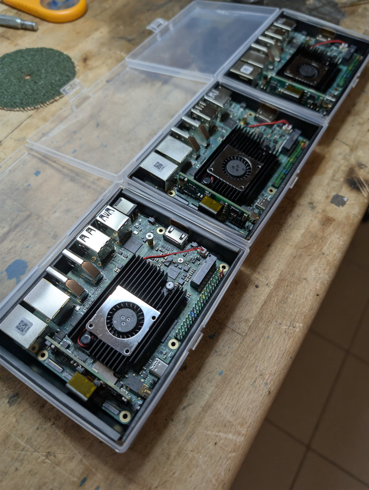

The result is this little beast: three Radxa Rock 5T boards, a Ubiquiti Flex 2.5G PoE with a single PoE++ cable and a properly grown‑up Kubernetes setup (Talos, Cilium BGP, Longhorn, Gateway API, Flux).

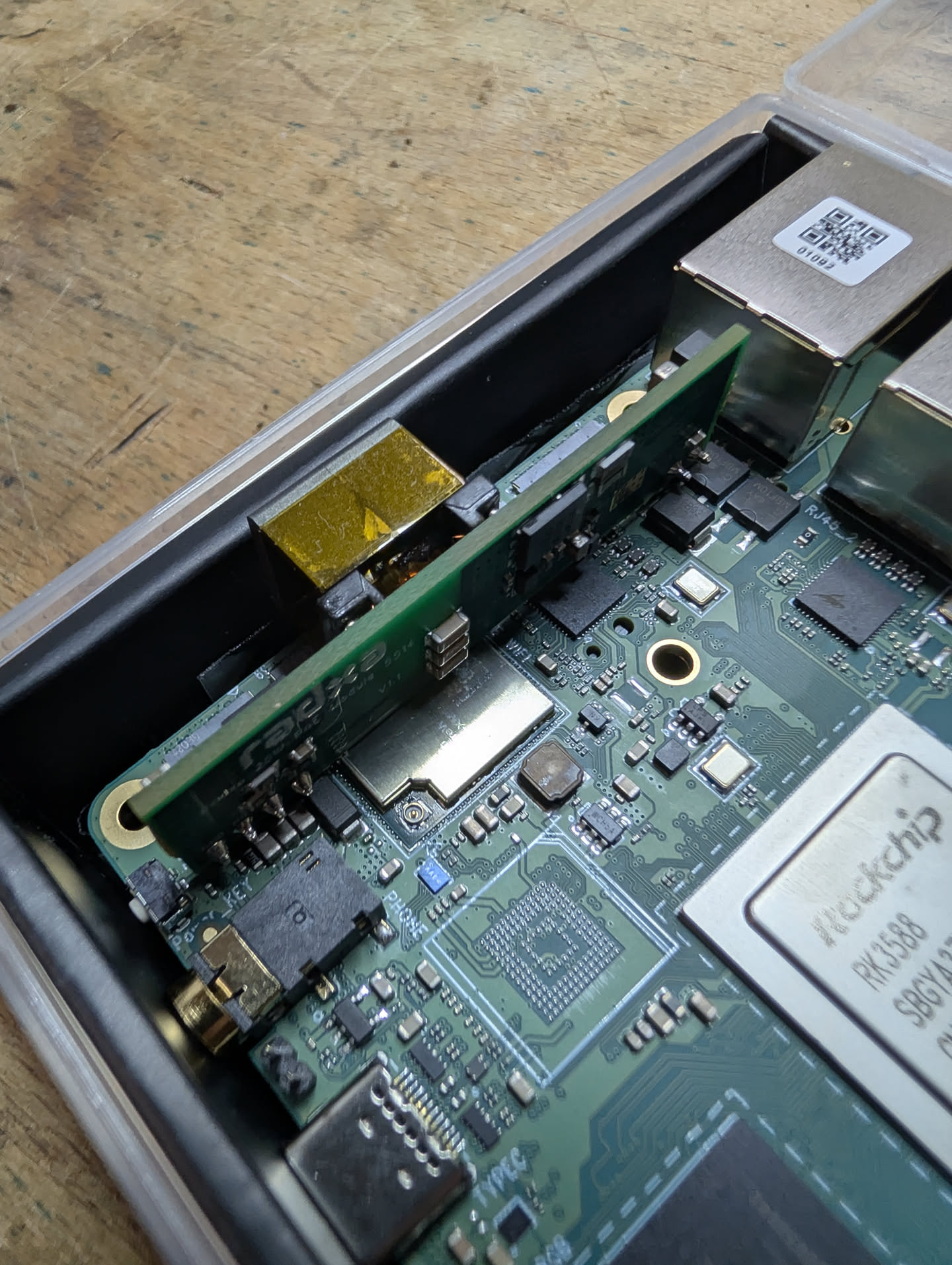

:electric_plug: PoE+ that actually works
Most SBC needs a HAT for PoE. The Radxa 25W PoE+ Module 5514 is a different story — it’s a proper 25W IEEE 802.3at module that can be soldered cleanly onto the board and reliably delivers the power budget the Rock 5T needs under load.

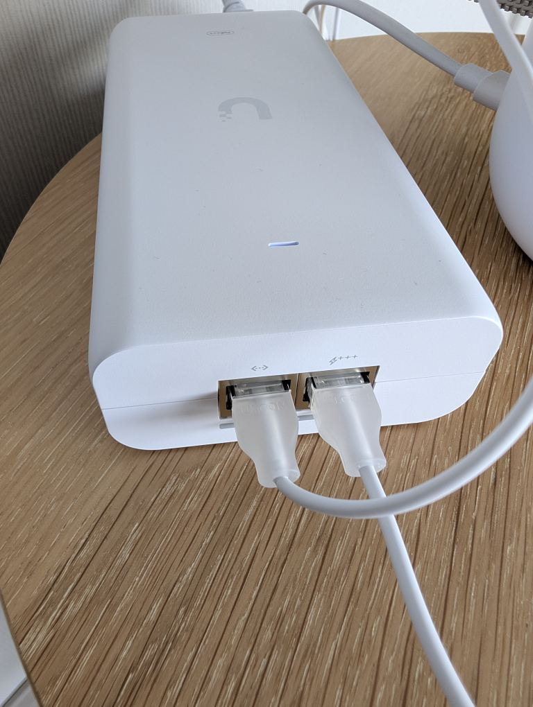

Combined with a Ubiquiti 10G PoE+++ Adapter (90W) injector feeding a Ubiquiti Flex 2.5G PoE, the entire cluster runs off one cable from my router. No wall warts, no USB-C bricks, no power strip gymnastics. One cable to rule them all. :sweat_smile:

Ubiquiti UACC 10G PoE+++ Adapter (90W) 1 Powers switch + entire downstream cluster

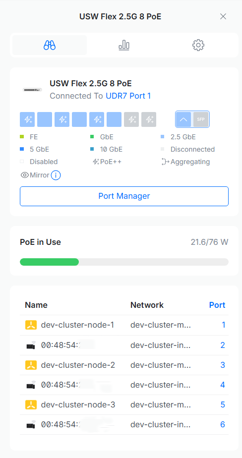

:high_voltage: Power budget
Item Idle Peak
3× Rock 5T + NVMe (incl. PoE+ overhead) ~20 W ~45 W
Flex 2.5G PoE (system) ~7 W ~9 W
Total at the wall ~27 W ~54 W
Comfortably inside the PoE availability of 76 W with PoE+++ input

Each Rock 5T has two 2.5 GbE NICs and I use both, with completely separated roles:
NIC VLAN Subnet Purpose
enP4p65s0 (NIC 1) 10 — management 10.10.1.0/24 Home LAN, Kube API, Gateway API, BGP sessions, VIPs
enP3p49s0 (NIC 2) 11 — internal 10.10.2.0/24 Pod-to-pod traffic only — isolated

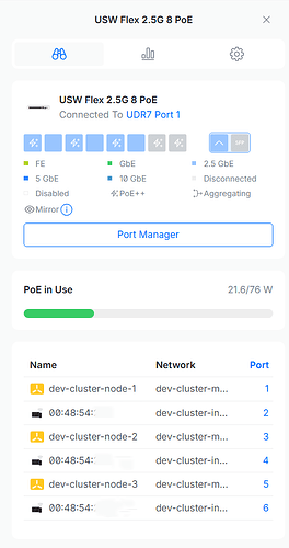

Each Rock 5T has two cables going into the Flex 2.5G PoE. Configure each port in UniFi → Devices → Switch → Ports:
Port Native VLAN Tagged VLANs Auto PoE
NIC 1 (enP4p65s0) dev-cluster-management (10) Block All :white_check_mark: (powers the board via PoE+ module)
NIC 2 (enP3p49s0) dev-cluster-internal (11) Block All :cross_mark:
:safety_pin: Both ports use Uplink mode, not Edge. “Block All” on tagged VLAN management means no VLAN trunk — each port carries exactly one untagged network. NIC 1 and NIC 2 are physically on different VLANs at the switch level, which reinforces the isolation even before Talos/Cilium enforce it in software.

Looks awesome and compact, I still have mine cluster based on 16/32GB of 5B. Single ethernet, but easy to change eMMC so it can keep only system itself. For me longhorn was a failure, it was never stable enough and put way too much overhead into simple stuff. On v1 they use old iscsi, on v2 they require core per node just to maintain low latency. Longhorn also failed on several updates braking volumes :slight_smile: I’ll give it a try for sure in future, but for now I can make better strategy for my purpose.
I can see that you don’t have a case. To fix the high nvme temperatures, I used a Rock 5B case by KKSB and coupled the SSD on the underside to the case using 2 thermal pads with a piece of copper between them. This brought down the SSD temperatures under load by almost 20 degrees.
A case for the 5T like the KKSB for the 5B would be really nice. I only found the Radxa Metal Case 1290 but it doesn’t fit very well with the soldered Radxa 25W PoE+ Module 5514, and I think it would be even worse in terms of temperatures.
Great work! This was my reference k8s stack some years ago, glad to see Talos have first class overlays on the rk3588.
