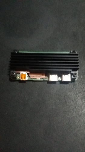

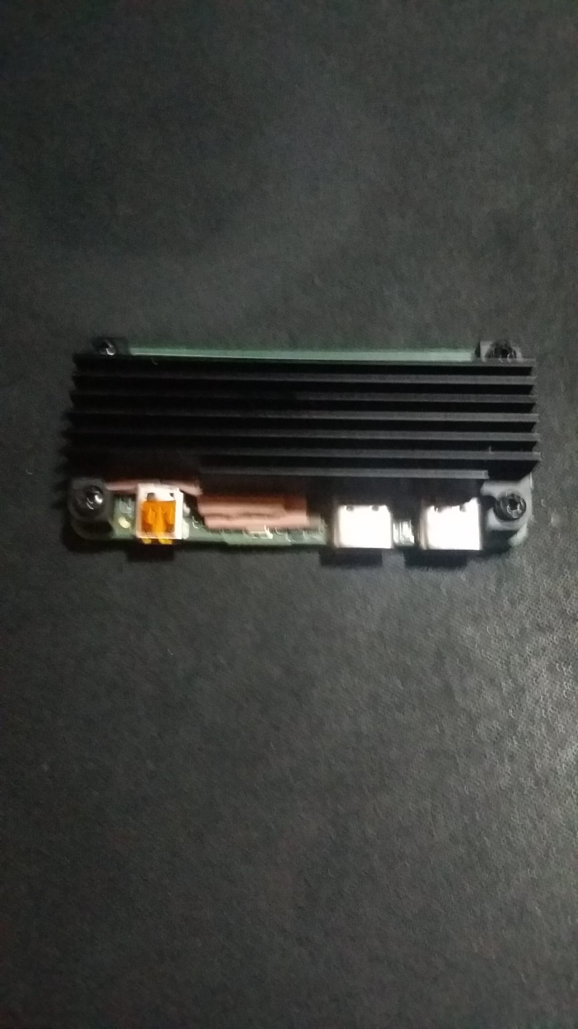

Using the configuration below my radxa does not exceed 60 C running with FreeBSD in idle and with a low load :
Never tested if I stress it a lot. yeah,can reach 70 C. I know that the only method to keep the temp all around 50 C is to use these ones :
https://forum.radxa.com/uploads/default/original/2X/6/6a3f600c92c312b8ac6b7144d1c9d60089014697.jpeg
but then the board becomes not usable for the FreeBSD based phone that I’m building.
No one saw a phone with two cooling active fans :stuck_out_tongue:
