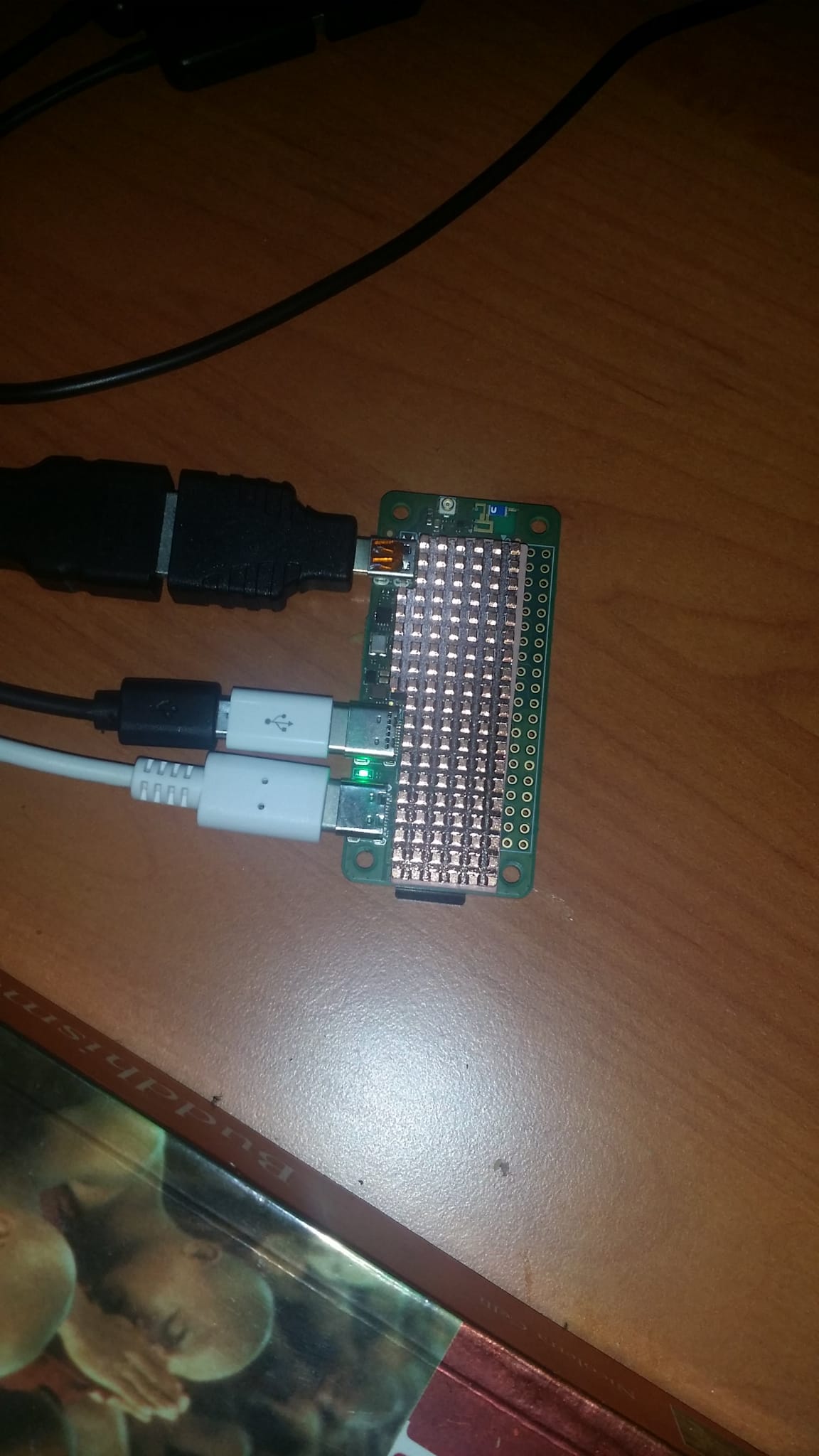

I’ve bought this heatsink for my radxa 3W :
https://it.aliexpress.com/item/1005007015761488.html
and I’ve applied it on top of the board :

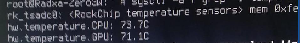

The problem is that…it does not work,as u can see below,the temperatures are very high,anyway :
where is my error ? what should I do to keep the temperatures down ?
(I’m using FreeBSD 14.2-RELEASE).

This is what I did,but the temperatures are still very high :
the official “heatsink specially designed for the radxa zero 3W” does not work at all.

  1. the same
  2. Is there a good contact between CPU and heatsink ? yes
  3. Have you used thermal compound ? No,I used the heatsink as is,as it has been sold.
    • Have you tried using different heatsink? E.g. Waveshare heatsink reduces CPU temperature by about 20°C for us (RPi Zero 2W) - https://www.waveshare.com/product/pi-zero-case-b.htm (it fits on Radxa Zero too but I’m not sure about 3W) : nope. I’ve ordered this one :
  1. almost in idle mode.
Despite everything. If I buy something that claims to be able to perform the task for which I bought it and it doesn’t,there is a problem somewhere and this problem cannot be caused by me. And this is confirmed by the various complaints that I read on the net. For sure I can change something,but I didn’t read on the page of the vendor that I should add this or that new component. It should work as it has been sold. This is how usually works. Even more if the description says “especially built for the radxa zero 3W”. I can’t do anything else but glue the sticky plastic over the circuits and place the aluminum heatsink on top of it. There is no other way to do this.

I have “silicone morbido cuscinetto conduttivo termico conduttivo” between the circuits and the heatsink.
This is how is the full product :
If you touch the heatsink with your fingers while the board is running and some driver reports +70°C… does it hurt? Does it feel warm at all?
—> If you touch the heatsink with your fingers while the board is running and some driver reports +70°C… does it hurt? Does it feel warm at all?
yes,yes,does it hurt. There is only a method to decrease the temperature from 70 to 50 :
to point the airflow that comes from a small fan above to the top of the board.
The product seems to be right but please do not consider that it works just becasue seems.
The temp in the base of the heatsink has to be similar to CPU.
tell you becasue I had problems with thermal pad that do not transfer heat to heatsink.
Which heat? Guys, this board here is equipped with a dog slow RK3566, tested by @geerlingguy a while ago on another board: Results for Orange Pi Compute Module 4 · Issue #84 · ThomasKaiser/sbc-bench · GitHub
With SoC vendor’s BSP (Board Support Package, a Linux kernel 5.10.160 with proper driver support for all of the SoC’s internal sensors) this SoC idles at 34.4°C and shows 61.7°C under full load without any heatsink attached at all: https://github.com/ThomasKaiser/sbc-bench/blob/master/results/reviews/OrangePi-CM4.md
I’ve installed FreeBSD on the Radxa 3W,not Linux. Probably FreeBSD does not have the driver which support the Socs internal sensors. So. I should low the temperature via hardware.
