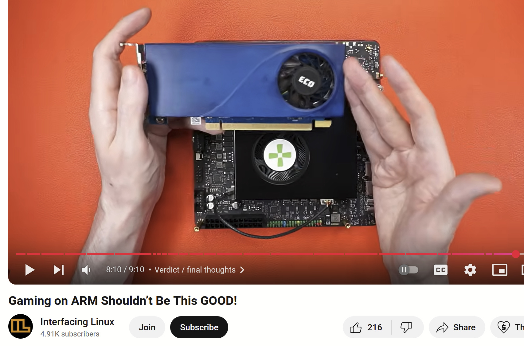

Do PCIe 4.0 GPU cards work if the PCI bus is forced to work in PCIe 3.0 mode&speed only?
Like you, this YouTube guy also experienced GPU with PCIe v3 work and with v4 not work: https://youtu.be/LHd3LCIGgkQ?t=482
