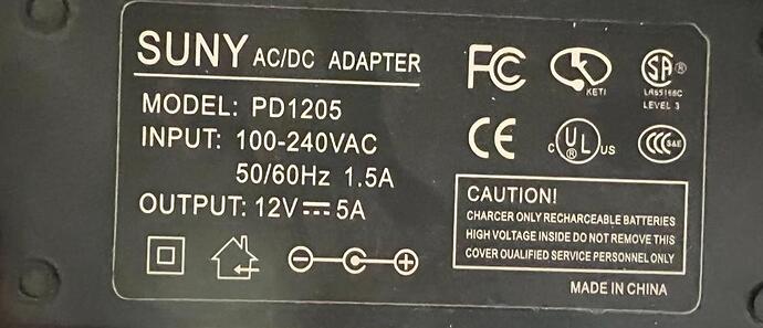

what power adapter are you using and how do you power the sata hat?
I think you connect USB HDD on the two USB 2.0 ports? Raspberry Pi 4 can not power USB HDD on the USB 2.0 ports.
