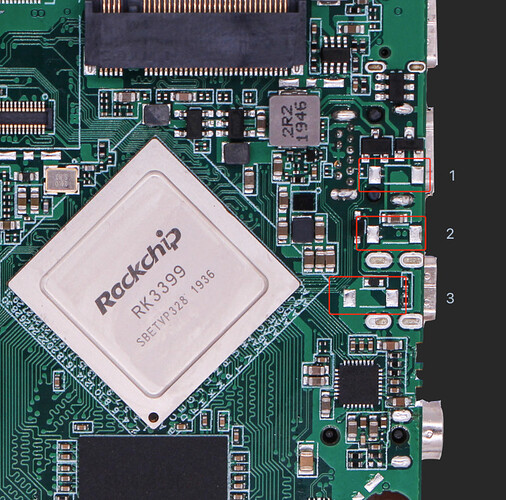

Where is this pad?
@jack Are you here?
Sorry for the late reply.
  1. SW2101 → RESET
  2. SW1500 → Maskrom (eMMC disable)
  3. SW2102 → Recovery(ADC key)
Refer:
https://dl.radxa.com/rockpi4/docs/hw/rockpi4/rockpi_4c_v12_components_reference_20200602.pdf
https://dl.radxa.com/rockpi4/docs/hw/rockpi4/rockpi_4c_v12_sch_20200620.pdf
I need power button (PWR_KEY_L), where is it?
I am sorry, i was wrong. There is no power button exported on the board.
