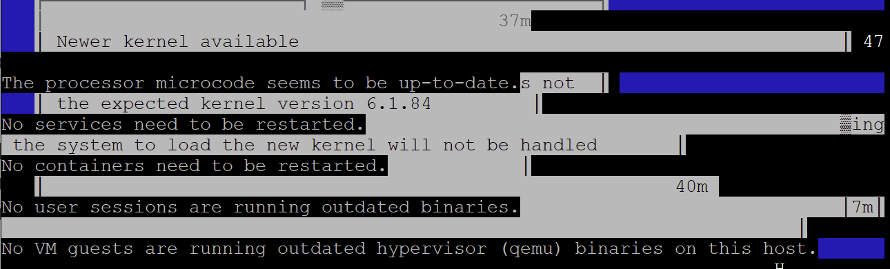

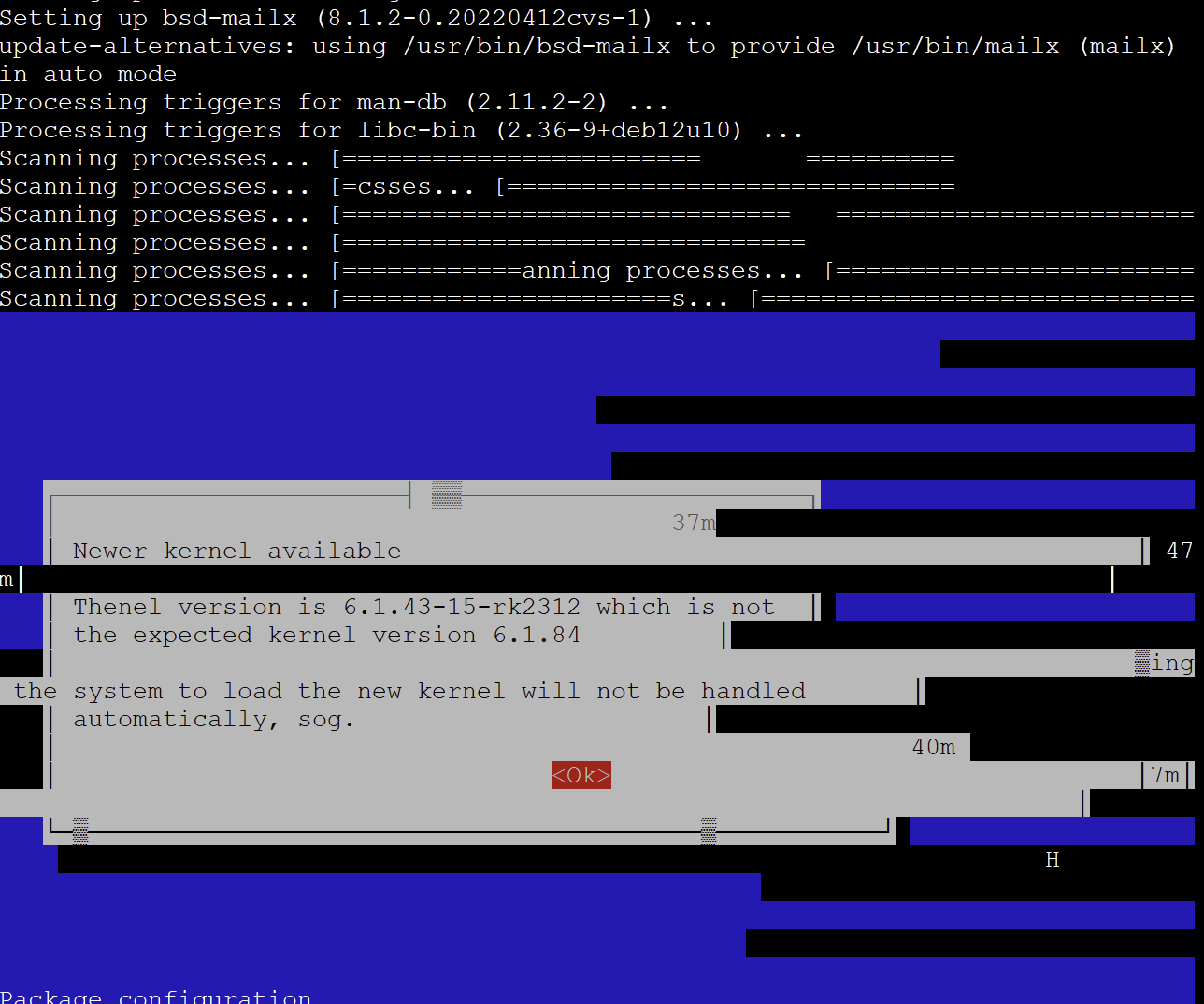

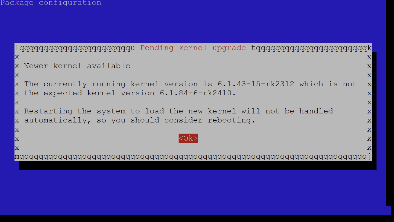

At the end it said this:
It also said some daemons are outdated. Just clicked Ok. And then ran reboot. Looks like all worked fine.
