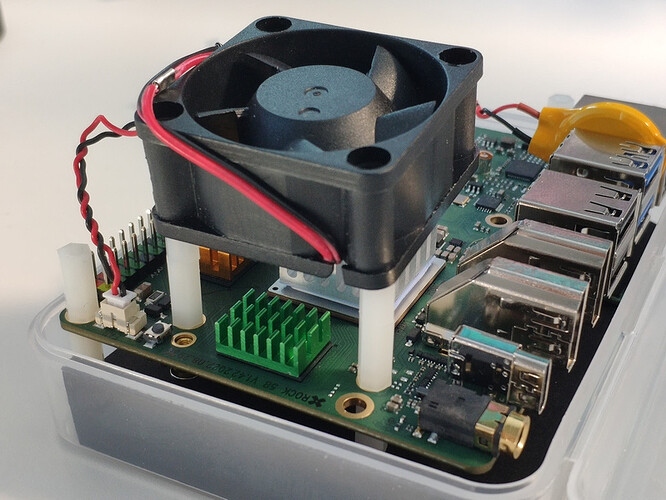

A quick ebay https://www.ebay.co.uk/itm/304627003246 as had some thermal tape anyway and No2 (2.2mm x 16) just screwed in between the vanes.
Standard 40mm 12 on top

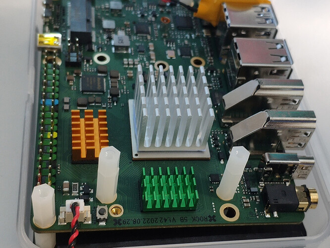

40x40 heatsink may be too big, here it’s 20x20 covering only rk3588:
white spacers are for 40x40 fan (which is way too big here, but this was quick setup).
I think that 30x30 heatsink should be ok unless there will be released some fitted large heatsink like the one for rock 4b
yes thats right but if you dont center the cpu on the 40X40 heatsink then it would maybe work
Yeah its just off centre and underneath that is a 20x20 copper shim that to be honest did not make any difference.
Should of twisted both heatsinks 90’ with hindsight so push/pull through both, but when I saw the temps I was getting with 100% stress running for extended times what I realised is not a lot of cooling thought is needed for this SBC as it seems to run super cool.
The additional ram heatsink I don’t think is at all nessacary, but is product of having tape and there was one on the desk…
