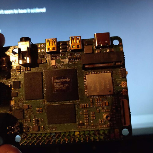

They had on board WIFI and M.2 E key slot in earlier revision.
pic is taken from discord:

Just because it was there does not mean that this was good idea, maybe it was just too slow or not working with m.2 at same time (which BTW is m.2 M slot for nvme). Hey, it was dev board :slight_smile:
Asks radxa team why they eventually decided to remove onboard wifi, probably they moved limited i/o somewhere else. One lane 2.1 nvme is not that great idea, usually You expect some speed from those drives and here is worst than on rock 3a board or even rock 4a/b/c.

While this for sure makes life little easier I expect that it’s not a big problem for such company to do certification if this is needed and by removing wifi they probably moved it’s io somewhere. I.e they could easily add it to near m.2 slot (but according to specs it’s not much there, one pcie 2.0 line).
Comparing different rk3588s board I see that we have either wifi or m.2 slot (that usually can take some wifi card). SOC just have very limited i/o and You can forget about nvme with speed like it’s on rk3588 (4x pcie 3.0). That’s why I think that something is wrong about included picture of dev board - nvme/ssd slot would be slow and wifi not replaceable by anything (or at least working together with m.2).
