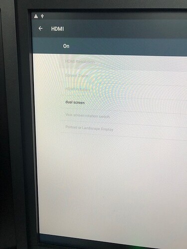

Hi, we have a Problem with HDMI rotation. Our customer use RockPi as Digital Signage Player with there own apk. In Android 7 and 9 this function is there if you go to settings display hdmi. He had only one board of 7 which has worked. The others are greyed out. Please help me with this issue our customer has a big project with this player.

Hi, thx for your help. We just need the manual function in the Settings.

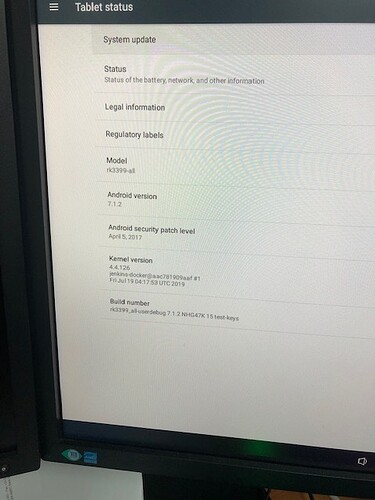

We had one Rock Pi and one EMMC in combination were settings has worked.
You can see pictures, totally strange. All other boards which we have tested are always with not working settings.

The customer is using this version https://github.com/radxa/manifests/releases/tag/RockPi-android7.1.2-20190719_1211
If you have downloaded the source code, modify it as follows
packages/apps/Settings:) git diff
diff --git a/src/com/android/settings/HdmiSettings.java b/src/com/android/settings/HdmiSettings.java
index f21085c..936e692 100755
--- a/src/com/android/settings/HdmiSettings.java
+++ b/src/com/android/settings/HdmiSettings.java
@@ -284,7 +284,7 @@ public class HdmiSettings extends SettingsPreferenceFragment
     private void updateHDMIState() {
         Display[] allDisplays = mDisplayManager.getDisplays();
         String switchValue = SystemProperties.get("sys.hdmi_status.aux", "on");
-        if (allDisplays == null || allDisplays.length < 2 || switchValue.equals("off")) {
+        if (allDisplays == null || allDisplays.length == 0 || switchValue.equals("off")) {
             mHdmiResolution.setEnabled(false);
             mHdmiScale.setEnabled(false);
             mHdmiRotation.setEnabled(false);
I tried it myself. Rotation is ok, but Resolution still has problems. We need time to debug it. Thanks.
