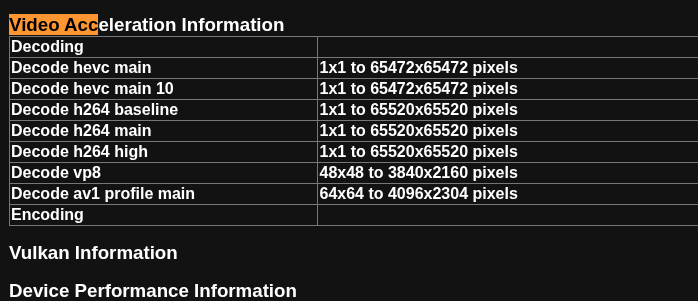

Graphics Acceleration / Performance
LiuJianFeng & PPA Graphics Panfrost/fork on Wayland
OpenCL runtime (libmali)
sudo add-apt-repository ppa:rockchip-linux/ppa
sudo add-apt-repository ppa:liujianfeng1994/rockchip-multimedia
sudo apt update ; sudo apt install mali-g610-firmware rockchip-multimedia-config glmark2 glmark2-es2 glmark2-es2-wayland mesa-utils malirun -y ; sudo apt upgrade -y
sudo add-apt-repository --remove ppa:liujianfeng1994/panfork-mesa
sudo add-apt-repository --remove ppa:liujianfeng1994/rockchip-multimedia
glxinfo|grep OpenGL -- check actual status of things

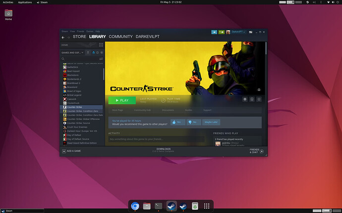

🎮 Steam
Steam Installation Tutorial
Easier method: Just install steam via Pi-Apps
wget -qO- https://raw.githubusercontent.com/Botspot/pi-apps/master/install | bash ; pi-apps
FEX-EMU or NicoD Armbian-Gaming Script

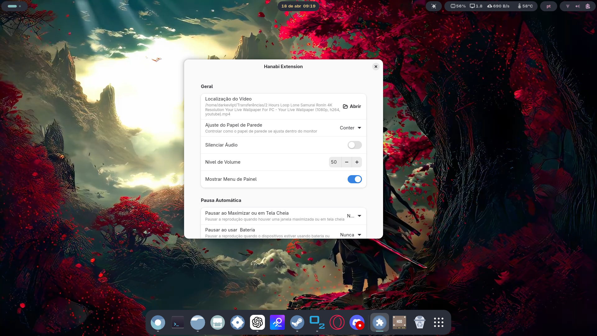

🎛️ Tweaks and Shell Extensions🎚️
Getting the Gnome Shell Extensions
sudo apt install gnome-tweaks gnome-shell-extension-manager chrome-gnome-shell -y
Open Tweaks and enable the dam Titlebar buttons (Why is this even disabled -.-’ )
You can now install ‘el’ gnome extensions:
  1. Enable User Themes
  2. Dash to Panel or Dash to Dock
  3. Freon or Vitals
  4. Compiz for an wobble effect.
