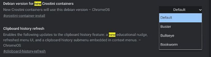

From v122 - Google officially added bookworm to crostini running kernel 6.1.

Manually edit googleapi package to an more recent version ‘122’ and set it to trixie:
deb https://storage.googleapis.com/cros-packages/122 bookworm main
Into:
sudo nano /etc/apt/sources.list.d/cros.list
This cros.list CANT be changed ! If changed… after a reboot it will reset.
  • Just change it update it and leave it.
    I don’t know if there will be a flag that allows it to be changed permanently without reset.
