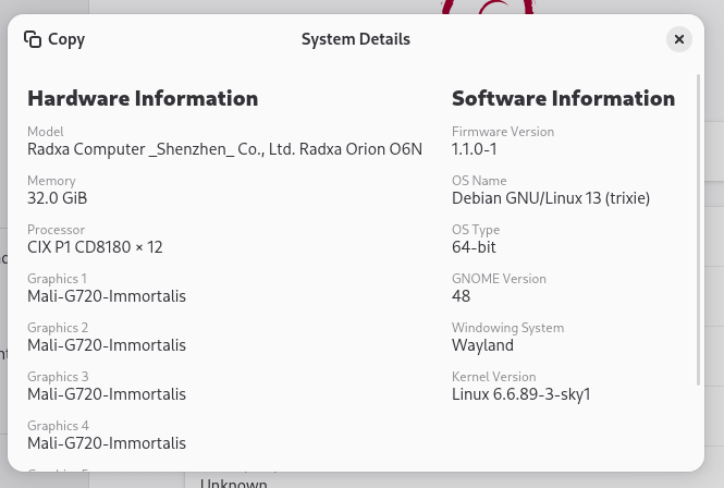

Hi guys,
I spent some time on this doing a lot of trial and error, so I’d like to share the result with you.
I managed to install Debian 13 on my Radxa Orion O6N with a working graphics driver.
It’s actually not that difficult.

The moment of truth:
now reboot your device and select Debian GNU/Linux, with Linux 6.6.89-3-sky1 DT in grub menu
The screen will go black for a moment, then you should reach the login screen. At this point the correct graphics driver is loaded, but rendering is still done in software.

What is working
  • Networking
  • Vulkan (version 1.4)
  • WebGL
  • HDMI audio output
  • YouTube plays smoothly but video decoding is still done in software
