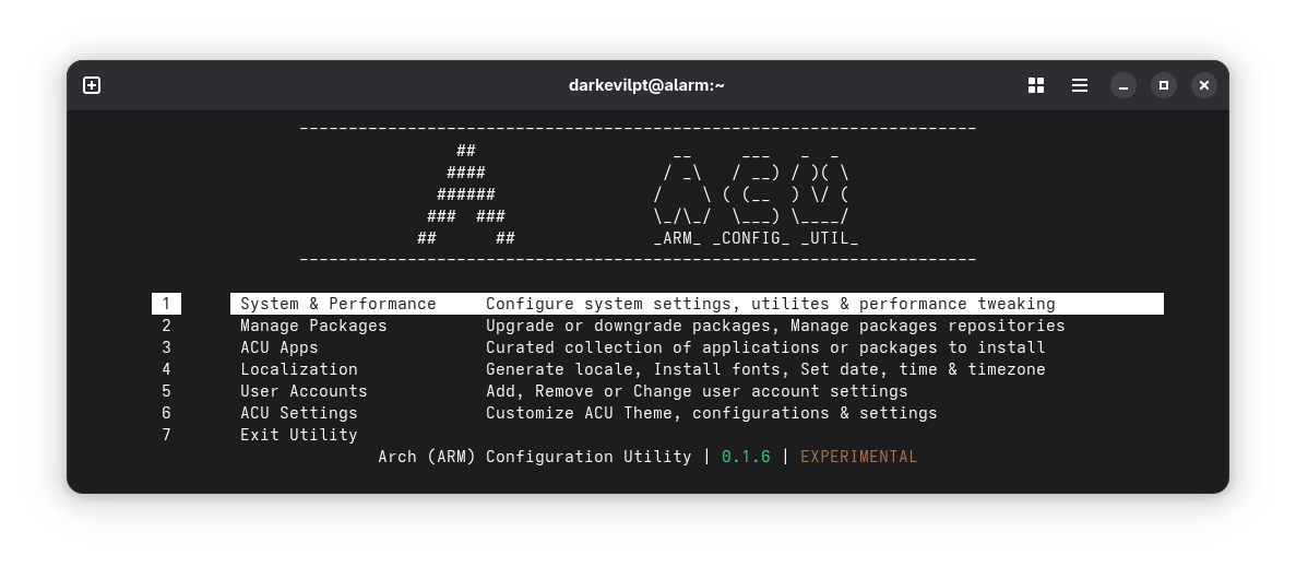

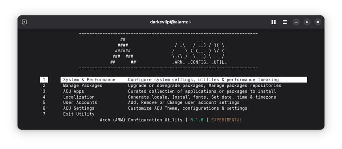

:backhand_index_pointing_right:t3: ARM Configuraton Utility aka ACU
ACU is a community-built tool designed for managing configurations and packages on Arch Linux ARM (still in beta development).
  • Type - 'acu' - acu install app -y # -y will work as expected ex: acu -y install chromium
  • Try acu --update=dev for the dev branch. Try acu -u and acu update for that updated status.
  • For everyone: bash <(curl -fsSL https://raw.githubusercontent.com/kwankiu/acu/main/acu) -u

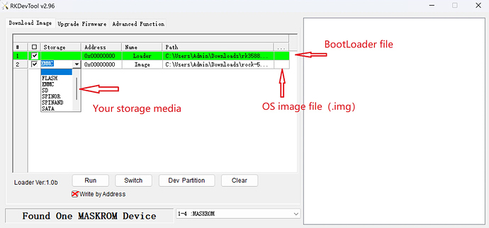

:floppy_disk: Flashing Images via Rockchip Dev Tools (Windows)
Use the Rockchip Dev Tools ( rkdevtools ) application on Windows to flash firmware images.
:toolbox: Step 1: Image Preparation
:backhand_index_pointing_right: Decompress the image files properly:
  • Use WinRAR to extract .img.xz files.
  • Do NOT use the built-in Windows “Extract All” option — it may fail or corrupt the image.
:framed_picture: Step 2: Image Flashing Settings
In rkdevtools , set the following options:
  • :white_check_mark: Tick “Write by Address” .
:wrench: Step 3: Bootloader File
Use the appropriate Rockchip bootloader SPL file for your device:
  • :page_facing_up: File Name: rk3588_spl_loader_v1.15.113.bin
  • :white_check_mark: This applies to RK3588 / RK3588S / RK356x / RK35xx / RK3328 / RK3399 / RK3582 / RK3566 / RK3568 / RK3588S / RK3528 / RK3576 , etc.
Download it from official sources or refer to the Radxa Docs for the latest version and usage guide.

Use the acu tool to enforce performance mode across the system-on-chip:
acu soc set performance
:white_check_mark: This ensures all subsystems (CPU, GPU, DDR, NPU) operate under the performance governor.
Android Linux

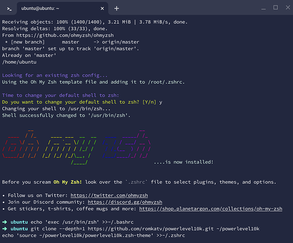

:hammer_and_wrench: Installing Zsh and Oh My Zsh
1. Install Zsh and set it as the default shell:
sudo acu install zsh nano -y
chsh -s $(which zsh)
2. Install Oh My Zsh :
Run the following command to install Oh My Zsh :
sh -c "$(curl -fsSL https://raw.github.com/ohmyzsh/ohmyzsh/master/tools/install.sh)"
When prompted, type Y to set Oh My Zsh as your default shell. This will also create a ~/.zshrc file in your home directory. You can edit this file later.
:counterclockwise_arrows_button: Make Zsh the Default Shell for Bash
If you’re still using Bash, you can set Zsh as the default by running:
echo 'exec /usr/bin/zsh' >>~/.bashrc
:collision: Install Powerlevel10k Theme
  1. Clone the Powerlevel10k repository :
git clone --depth=1 https://github.com/romkatv/powerlevel10k.git ~/powerlevel10k
  1. Add the Powerlevel10k theme to your ~/.zshrc
echo 'source ~/powerlevel10k/powerlevel10k.zsh-theme' >>~/.zshrc
  1. Change Zsh theme :Open your ~/.zshrc file:
nano ~/.zshrc
Change the ZSH_THEME line to:
ZSH_THEME="powerlevel10k/powerlevel10k"
Save and exit by pressing Ctrl + X , then Y .

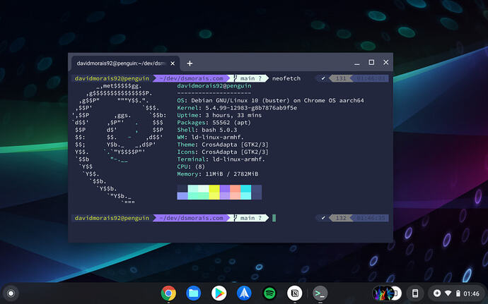

  1. Open a new terminal window with Ctrl + T and type zsh .Your terminal should now look something like this:
