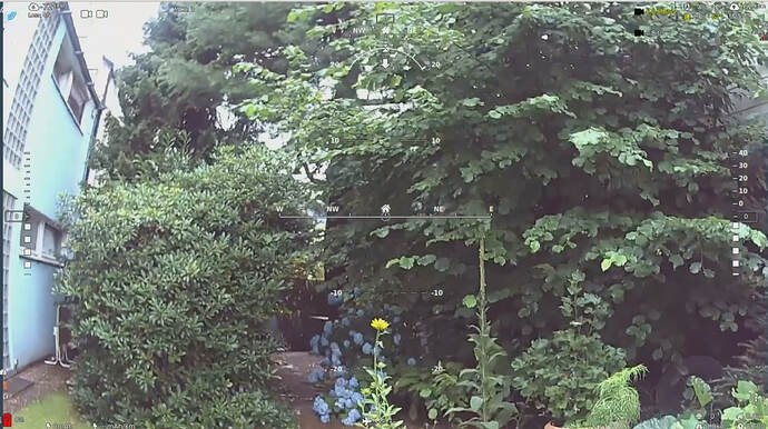

There has been some time since I last commented here, but I can finally say, the first prototypes have arrived and I was able to port the Arducam driver also to the Rock5A, I’ll share a picture which shows a Arducam Pivariety camera, tuning is not perfect yet and there might be a lot that needs to be improved but .. here is a proof of concept :slight_smile: (it’s also a little out of focus, didn’t have my glasses on while playing with it)
Out of curiosity, what are those avionics control-level things drawn on the screen?
It’s an open source digital video transmission system for drones. Which I develop for:
