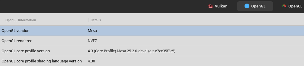

I have merged the ARM mesa changes with updated mesa-tkg that now has fixes for all of the recent mesa changes (removal of old opencl, removal of other old drivers, driver rename, etc) and enabled more driver builds.
I have succeeded in making a mesa 25.2 git build that now includes the standard nvidia nouveau/intel gpu drivers.
I don’t yet have an intel DGPU but I have successfully booted the Nvidia GT 630 on the first try.
On this card nothing will show up on the screen until it finishes booting, at least with the older BIOS I have on my Orion. I have a DP to dual link DVI adapter running 1440p from it ok as a reference.
Makepkg build script: mesa-git-intel_nvidia_amd_makepkg.tar
This makepkg should satisfy your AARCH64 driver build needs for DGPUs and panfrost drivers for the next several mesa releases.
Here is the built package that you can install onto the image that I released. (needs latest system updates to run)
mesa-tkg-git-25.2.0_devel.204953.e7ce35f3c50-1-aarch64.pkg.tar.xz

Now that image should boot on at least some older nvidia gpus.
Note that this does include the new MALI GPU support, so if you switch to a proper kernel it should work on the IGPU.
