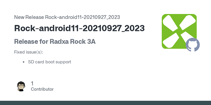

Android 11 Image For Rock3A Is Now Available
Android 11 image and also source code for Rock3A is now available(Download)
Release for Radxa Rock 3A
Currently support hardware/feature

Known issues:
  • Sdcard/Nvme boot
  • HDMI audio output
