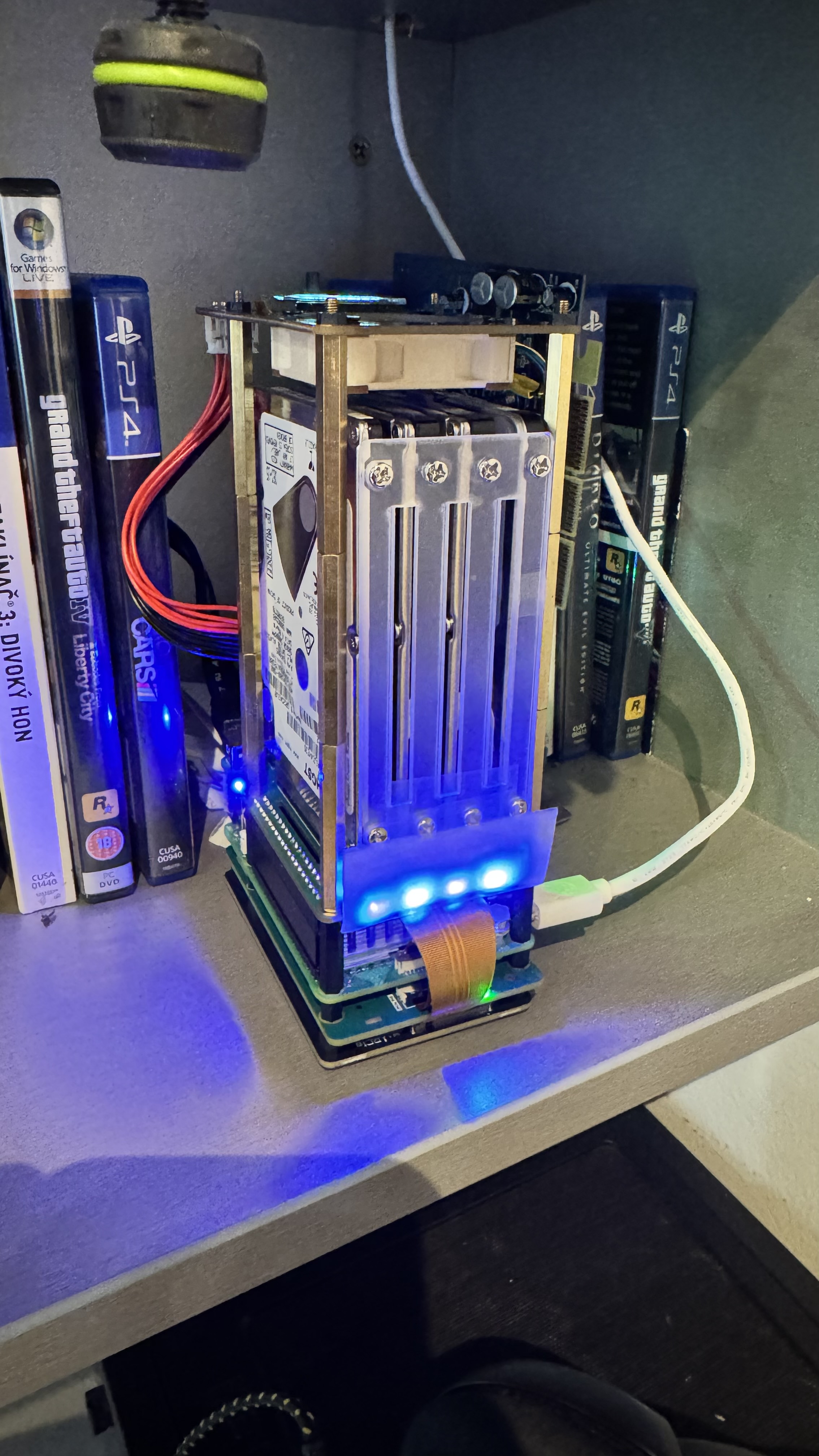

For future users: Given that I live in a hotter country, I had to do something about the temperature in my setup… it was running in the mid 50s (Celsius) when idle…
the basics:
  • SATA Quad Hat with
  • Raspberry Pie 4B
  • 3x SSD connected
Winter/Spring time was blissful and everything ran cool-ish… Summer temperatures started to rise, so did the CPU temperatures…
I followed some advice from here and further added some more mods:
  1. Reversed the stock CPU fan to blow onto the heatsink (needed other screws)
  2. changed the top fan for a Noctua 4pin PWM fan, rewired the existing(see pics) - also blowing to the inside. cable is just sliding down on the side
  3. added a USB fan on the bottom (blowing into the case) with a 3D printed cover to force the air through the enclosure and block the side escape route (see pic)
    3.a the cover has loops to zip-tie the cabels as needed
  4. added a dust filter (catching dust and cat hair :slight_smile: )
  5. it is now standing on the side with rubber feet attached and running very quiet
20 minute stress test on the CPU: without the bottom fan constant 70C (I think the Raspberry starts throttling to keep the temp). with the bottom fan it hovers around 60C… so, very happy with the result!

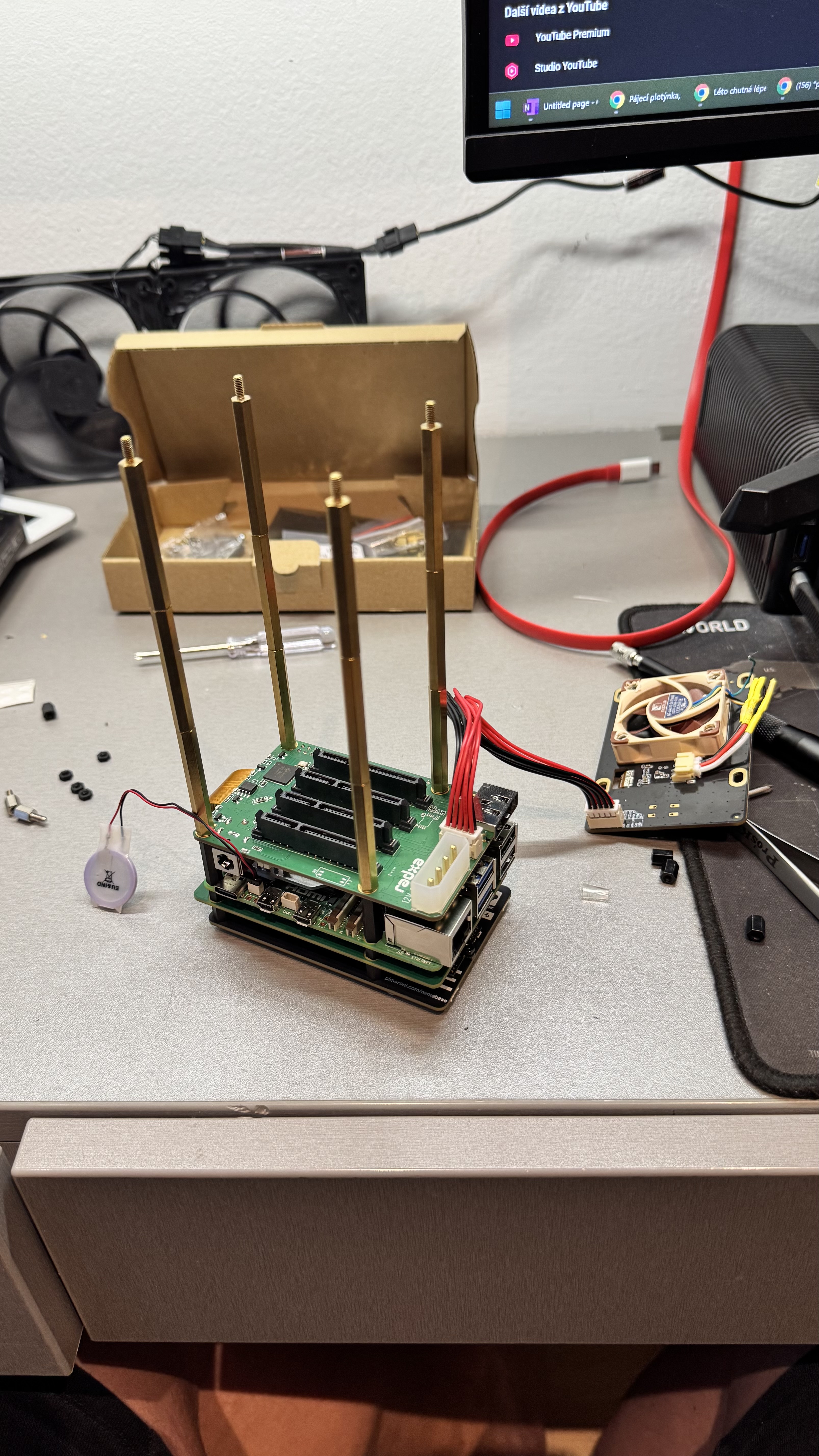

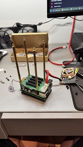

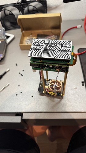

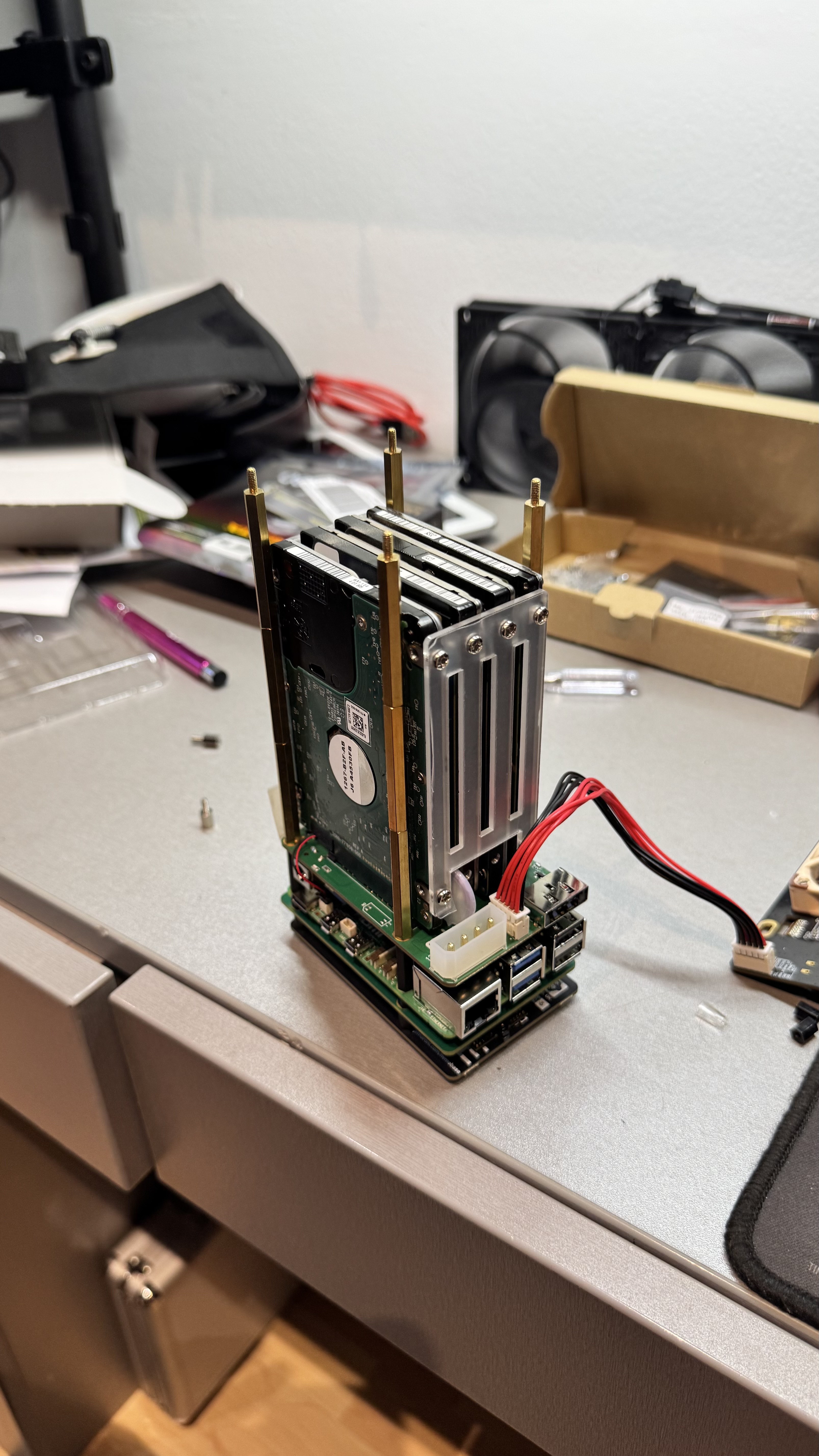

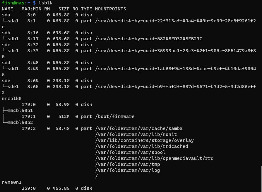

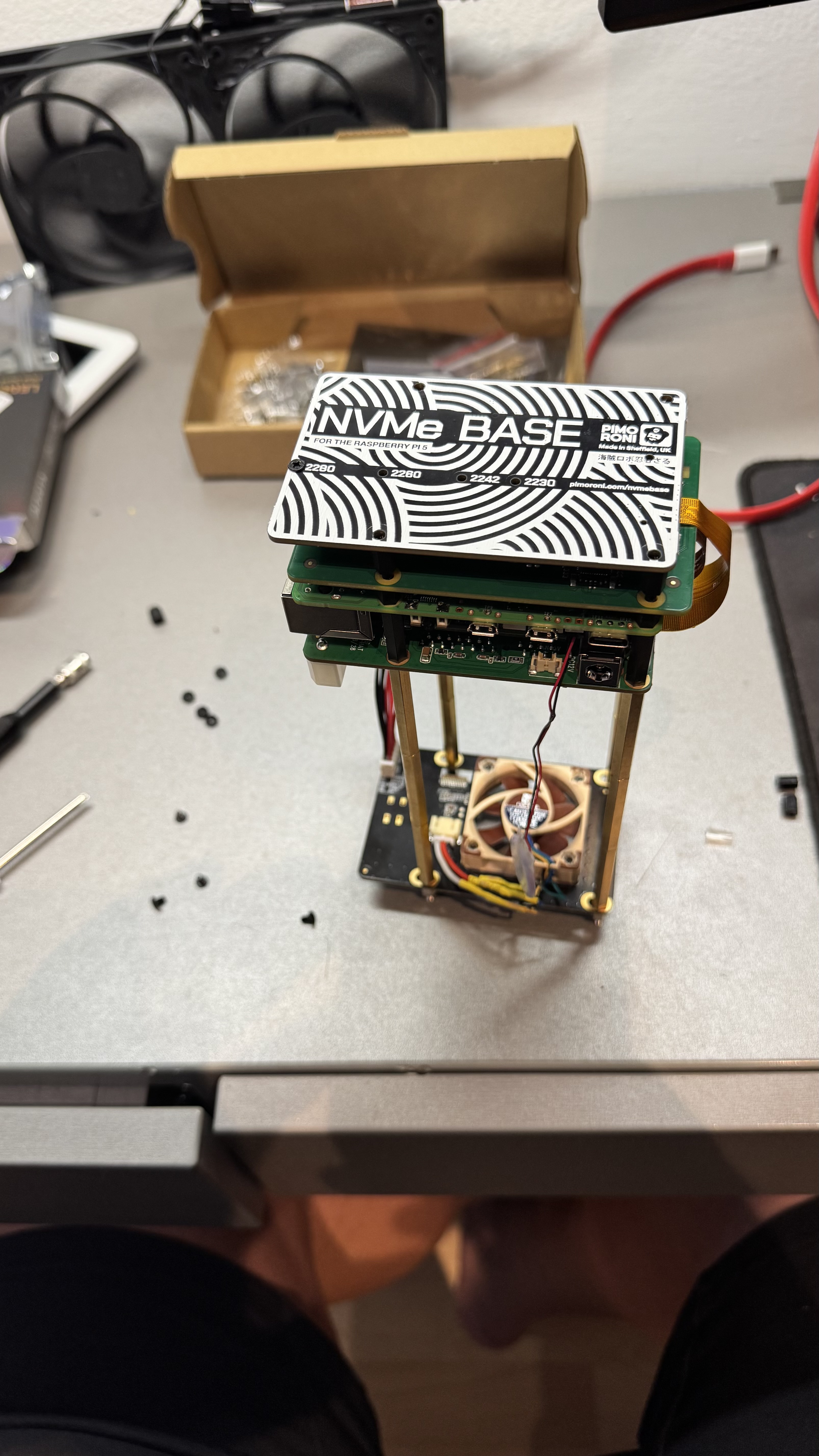

As of yesterday, my setup got a bit taller again. I have got rpi updated with pineboards hatbrick controller so I can connect pcie to penta sata hat and also Pinomori nvme base from which I am supposed to be able to boot.
Im curious how it will perform. :slight_smile:
Power: I was able to power it up using usbC original 45W PD
