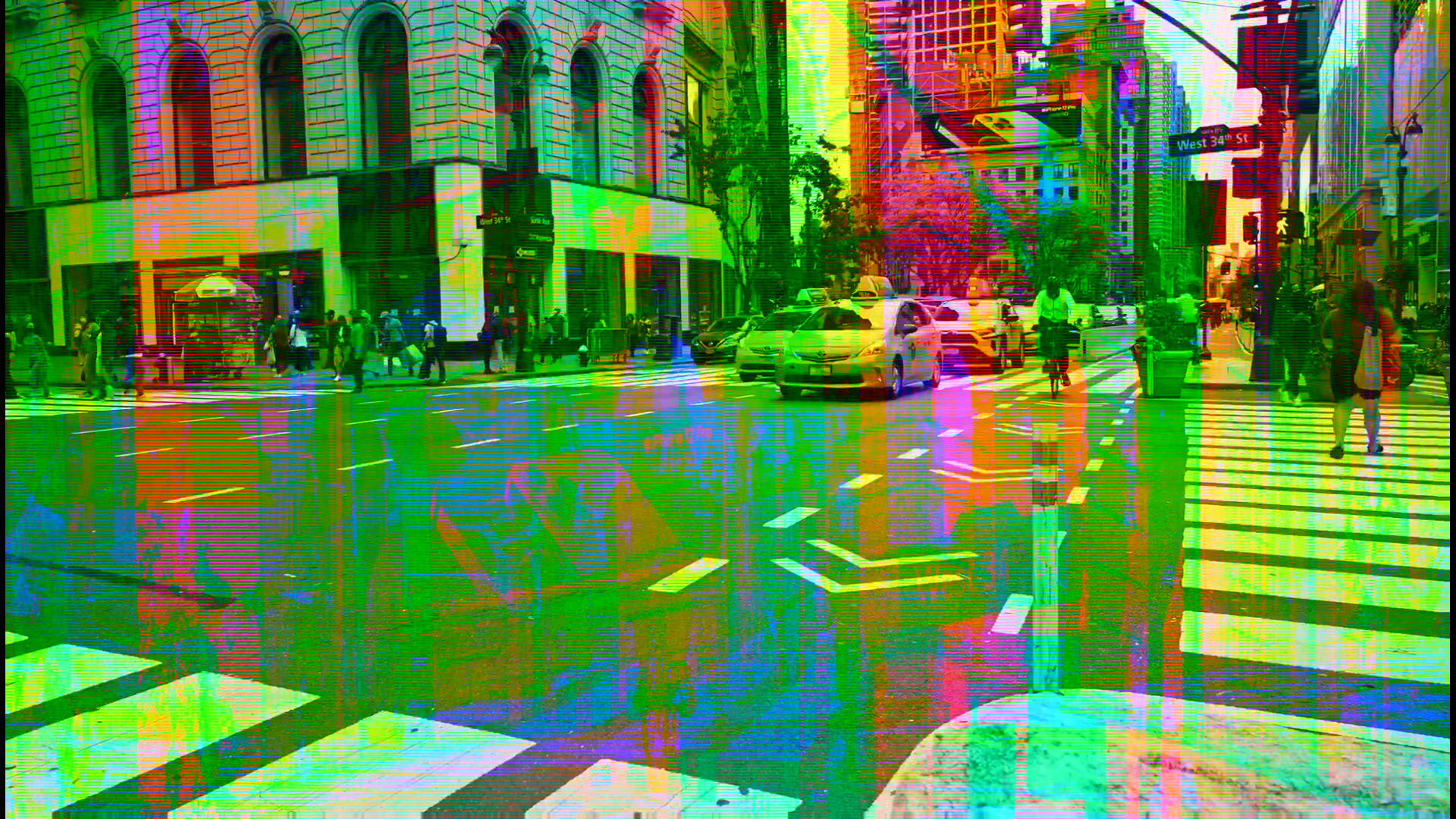

Let’s start with encoding using videotestsrc:
sudo gst-launch-1.0 videotestsrc is-live=true num-buffers=200 name=camera ! video/x-raw,width=1920,height=1080,framerate=30/1,format=NV12 ! queue ! omxh264videoenc target-bitrate=2000000 ! filesink location=test_video_nv12.h264
Setting pipeline to PAUSED …
DEBUG  : cedarc CdcIniParserInit:41: load conf file /etc/cedarc.conf ok!
DEBUG  : omx_venc <__AwOmxVencComponentCreate:2309>:  COMPONENT_CREATE
DEBUG  : cedarc AwOmxComponentInit:40: OMXCORE: aw_omx_component_init d1c26ee0
INFO   : cedarc <log_setlevel:73>: Set log level to 5 from /vendor/etc/cedarc.conf
Pipeline is live and does not need PREROLL …
Pipeline is PREROLLED …
Setting pipeline to PLAYING …
WARNING: omx_venc <__AwOmxVencGetParameter:896>: get_parameter erro: pParamData->nIndex > m_sInPortFormatType.nIndex,                        param index 3. impl in->index 2.
New clock: GstSystemClock
ERROR  : cedarc getDefaultParameter:35: getDefaultParameter. UnsupportedIndex 100663312. unkonwn param 0xffff94922750
WARNING: omx_venc dealWithInputBuffer:3630: skip this input buffer, pInBufHd:0xaaaad19e5c00,buffer_type=ebebebeb,buf_size=0
Got EOS from element “pipeline0”.
Execution ended after 0:00:06.678020840
Setting pipeline to NULL …
WARNING: cedarc VideoEncUnInit:361: the VideoEnc is not init currently
Freeing pipeline …
We can now confirm the encoder accepts NV12 1920x1080 single plane buffers:

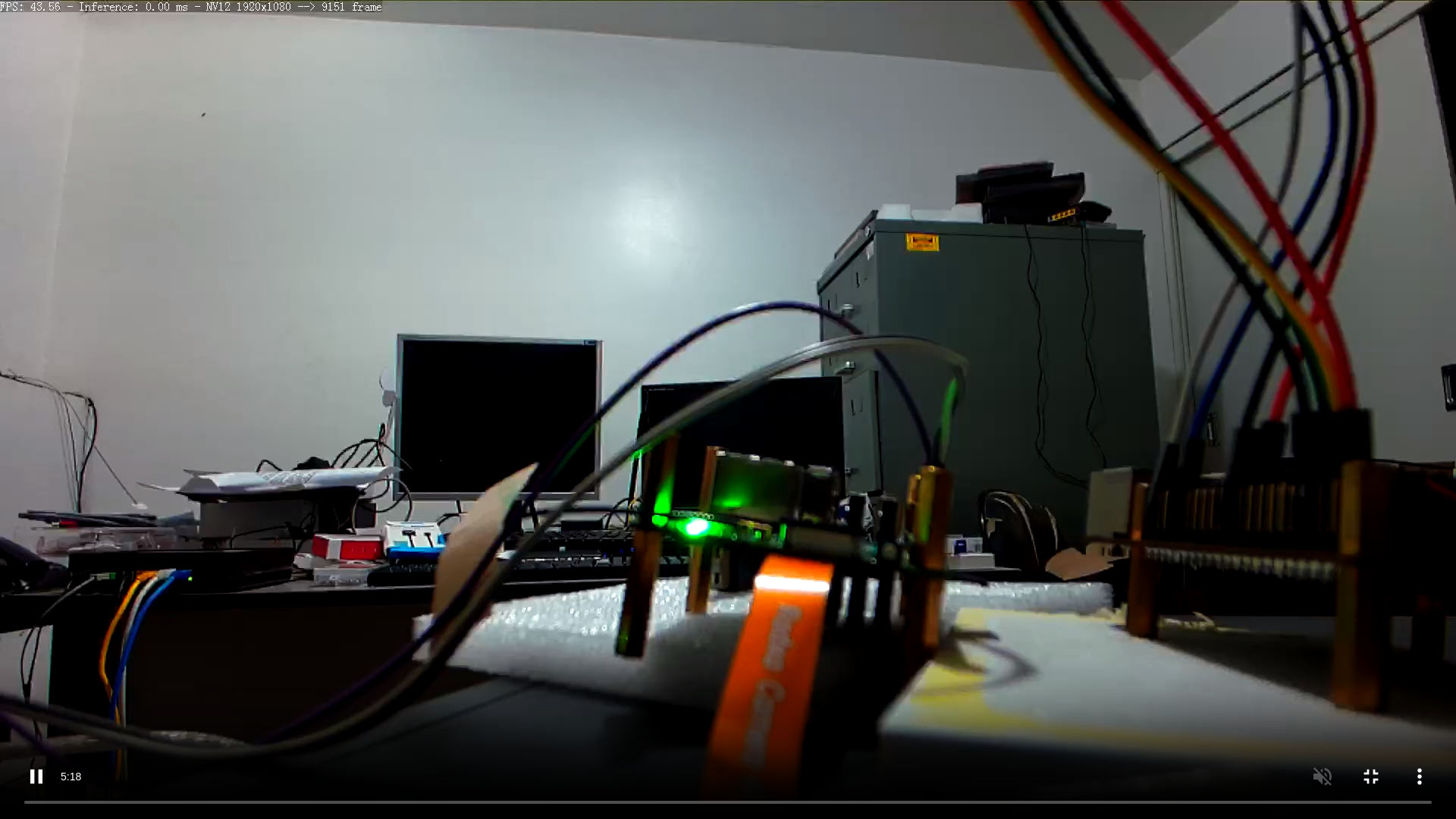

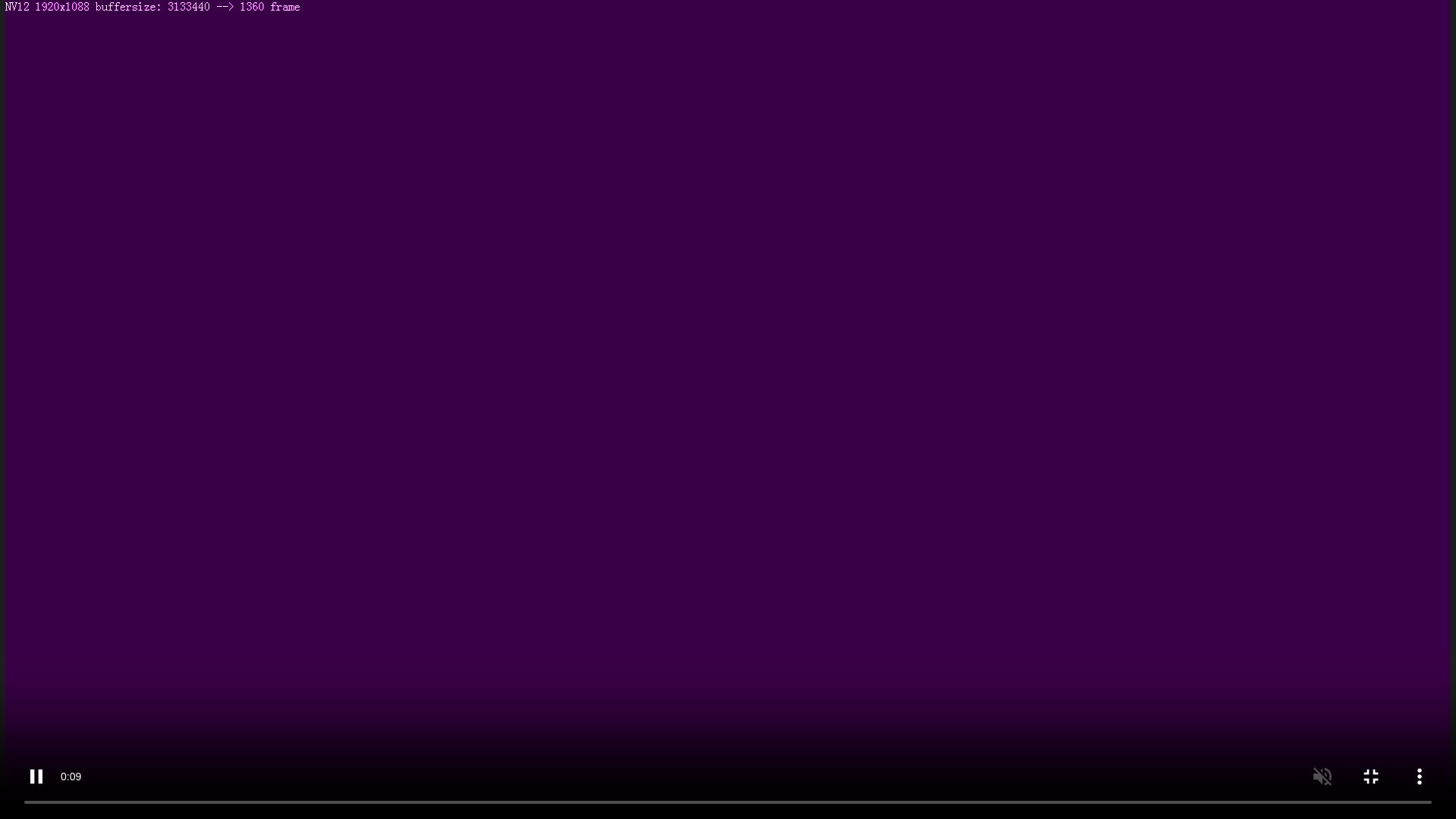

Now things get ugly with the current gstreamer state, let’s grab some frames from the camera (imx415 or imx214), encode and record them to a file:
sudo gst-launch-1.0 -e v4l2src device=/dev/video0 en-awisp=1 en-largemode=0 num-buffers=200 ! video/x-raw,format=NV12,width=1920,height=1080,framerate=30/1 ! queue max-size-buffers=18 ! omxh264videoenc target-bitrate=2000000 ! filesink location=stream_cam.h264
DEBUG  : cedarc AwOmxComponentInit:40: OMXCORE: aw_omx_component_init 17f4850
[ISP]>>>>>>>>>>>>>>>>>>>> ISP VERSION INFO <<<<<<<<<<<<<<<<<<<
IPCORE: ISP602
branch: libisp-dev
commit: 665dc2e9613716c25abb6b64af145a73b989271e
date  : Wed Dec 18 15:26:13 2024 +0800
author: [email protected]
[ISP]video device name is vin_video0
[AWIspApi]: F:awIspGetIspId, L:104, video0 → isp0
[ISP]tdm_rx device name is sunxi_tdm_rx.0
[ISP]open isp device[0] success!
[ISP_WARN]VIDIOC_VIN_GET_SENSOR_OTP_INFO return error:Invalid argument
[ISP]ISP0 OTP Disable
[ISP]get isp_ctx from /mnt/isp0_1920_1080_30_0_imx415_mipi_ctx_saved.bin success!!!
[ISP]detect /mnt/ success.
[ISP]find imx415_mipi_1920_1080_30_0 [imx415_mipi_1080p_isp_cfg] isp config
[ISP]create isp0 server thread!
[ISP_ERR]isp_dev_start, line: 717,unable to subscribe to tdm event: Inappropriate ioctl for device (25).
[ISP_ERR]isp_stat_process_buffer, line: 265,AEWB: stats error, skipping buffer.
[ISP_WARN]imx415_mipi get sensor_flip failed: Invalid argument (22).
[ISP_WARN]imx415_mipi get sensor_temp failed: Invalid argument (22).
[ISP_ERR]isp_sync_debug_info, line: 857,VIDIOC_VIN_ISP_GET_INFO error!
[ISP_WARN]isp debugfs node not support!!!
ERROR  : cedarc getDefaultParameter:35: getDefaultParameter. UnsupportedIndex 100663312. unkonwn param 0xffff963fb750
WARNING: omx_venc dealWithInputBuffer:3611: skip this input buffer, impl->mInBufHdr->nTimeStamp 4713096
EOS received - stopping pipeline…
Execution ended after 0:00:04.696637826

Frame: 1 - Caps: video/x-raw, format=(string)NV12, width=(int)1920, height=(int)1080, framerate=(fraction)30/1, pixel-aspect-ratio=(fraction)1/1, colorimetry=(string)bt709
ERROR  : cedarc getDefaultParameter:35: getDefaultParameter. UnsupportedIndex 100663312. unkonwn param 0xffffa17fa750
Frame: 20 - Caps: video/x-raw, format=(string)NV12, width=(int)1920, height=(int)1080, framerate=(fraction)30/1, pixel-aspect-ratio=(fraction)1/1, colorimetry=(string)bt709
Frame: 40 - Caps: video/x-raw, format=(string)NV12, width=(int)1920, height=(int)1080, framerate=(fraction)30/1, pixel-aspect-ratio=(fraction)1/1, colorimetry=(string)bt709
Frame: 60 - Caps: video/x-raw, format=(string)NV12, width=(int)1920, height=(int)1080, framerate=(fraction)30/1, pixel-aspect-ratio=(fraction)1/1, colorimetry=(string)bt709
Frame: 80 - Caps: video/x-raw, format=(string)NV12, width=(int)1920, height=(int)1080, framerate=(fraction)30/1, pixel-aspect-ratio=(fraction)1/1, colorimetry=(string)bt709
Frame: 100 - Caps: video/x-raw, format=(string)NV12, width=(int)1920, height=(int)1080, framerate=(fraction)30/1, pixel-aspect-ratio=(fraction)1/1, colorimetry=(string)bt709
Frame: 120 - Caps: video/x-raw, format=(string)NV12, width=(int)1920, height=(int)1080, framerate=(fraction)30/1, pixel-aspect-ratio=(fraction)1/1, colorimetry=(string)bt709
Frame: 140 - Caps: video/x-raw, format=(string)NV12, width=(int)1920, height=(int)1080, framerate=(fraction)30/1, pixel-aspect-ratio=(fraction)1/1, colorimetry=(string)bt709
Frame: 160 - Caps: video/x-raw, format=(string)NV12, width=(int)1920, height=(int)1080, framerate=(fraction)30/1, pixel-aspect-ratio=(fraction)1/1, colorimetry=(string)bt709
Frame: 180 - Caps: video/x-raw, format=(string)NV12, width=(int)1920, height=(int)1080, framerate=(fraction)30/1, pixel-aspect-ratio=(fraction)1/1, colorimetry=(string)bt709
Frame: 200 - Caps: video/x-raw, format=(string)NV12, width=(int)1920, height=(int)1080, framerate=(fraction)30/1, pixel-aspect-ratio=(fraction)1/1, colorimetry=(string)bt709
WARNING: omx_venc dealWithInputBuffer:3611: skip this input buffer, impl->mInBufHdr->nTimeStamp 4742377

What happened here? Accessing the buffer hangs the gstreamer due to memory leaks or race conditions, most likely what AI has suggested:
Pipeline Hangs: If the pipeline is stalled (e.g., due to encoder FIFOs filling up or async state changes), buffers may never be released, causing the mapping thread to block indefinitely.
This can happen with fewer buffers than are shown here.
And you can notice the buffer size is now 3133440 → 1920x1088 (padding?) and not 3110400 → 1920x1080 anymore.
So, we cannot access the buffer to manipulate the frame as we need in real-time. looks like gst_object_unref() is missing or the buffers are not synced properly.
I noticed that after I updated libcedar and gstreamer videoconvert started changing the buffer size as well, already reported here in the forum. Gstreamer videoconvert not compatible with hardware encoding
I hope Radxa can ask the gstreamer maintainers (Allwinner?) to fix this MAPPING issue and videoconvert. I could not find the source code anywhere to get a better understanding. Any pointers?

The result:
It seems the default videoconvert output is YV12 1920x1088 and perhaps omxh264videoenc is expecting NV12 1920x1080.
Frame: 1 - Caps: video/x-raw, format=(string)YV12, width=(int)1920, height=(int)1088, interlace-mode=(string)progressive, multiview-mode=(string)mono, multiview-flags=(GstVideoMultiviewFlagsSet)0:ffffffff:/right-view-first/left-flipped/left-flopped/right-flipped/right-flopped/half-aspect/mixed-mono, pixel-aspect-ratio=(fraction)1/1, chroma-site=(string)mpeg2, colorimetry=(string)bt709, framerate=(fraction)24000/1001
Frame: 1 - MAPPING START
Frame: 1 - MAPPING OK
Frame: 1 - size: 3133440
Frame: 1 - UNMAPPING DONE!

I went a little further, i did the following experiment:
I started pushing NV12 1920x1080 buffers with metadata to libcedar and using the wifi to access it via a browser from another X64 box. This kind of work but libcedar indeed accepted the NV12 1920x1088 2 planes buffers, but threw some errors and skipped a lot of buffers.
[ create NV12 1920x1088 2 planes ] –> [ push-feed ] –> encoder –> rtspclient
The next step, and that works, is to push raw NV12 1920x1080 to the encoder.
[ read raw frame ] –> pipe –> encoder –> rtspclient
I left it running for several hours until, because there was no airflow under the board, it reached 60ºC and libcedar started issuing errors.
