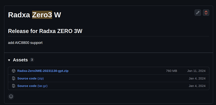

This version fixes the Wi-Fi issue.
https://github.com/radxa/manifests/releases/download/radxa-zero3-we-android11-rkr12-20240111/Radxa-Zero3WE-20231130-gpt.zip
Thank you, the problem is solved.
