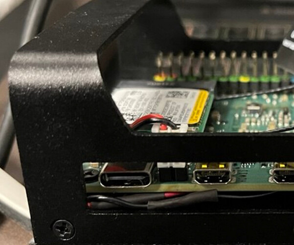

You can actually use any well-known 12v fan like Noctuah NF-A4x10 instead, taking off the frame and connecting it to the PWR-IN in between USB-C and HDMI1.
You will definitely enjoy the silence compared to the original one, and it looks pretty decent as well (sorry for the dusty photo)

thanks for the suggestion. Unfortunately my 12V PWR-IN is obscured by the POE board. However there is also a 5V version of that fan, so with a bit of cable magic i could use the original fan connector. How did you mount the fan in the radiator? it looks like you cut away the fan frame and then? tiny screws or superglue? would be interesting to hear your solution.
Thanks!
Yes, I cut the frame away and used a glue gun, as screws did not fit the fan mounting.
