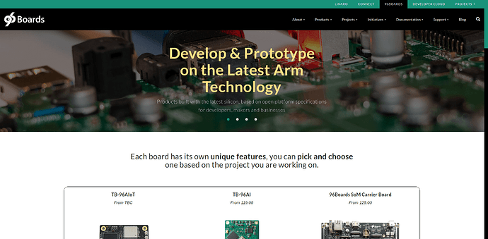

Well, the N10 is more than twice as big (100x100 vs 85x54) and one USB 3 port sticking out one side and the other one at the opposing end makes the total installation even bulkier. For that larger footprint there are a lot of good boards available, some of which perform considerably better than the RK3399 for not that much more.
such as?
The HiKey 970 for example.
Performance comparison:
The HiKey 970 board is labelled as ‘ARMv8 Cortex-A73’.
