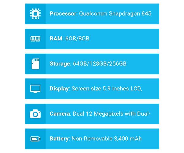

A phone running Windows vs SBC running Windows xD

RK 3588 at par with this wins ? Amazing :smiley: lets not give price ideas for Radxa plz :smiling_face_with_sunglasses::smirking_face:
Same SoCs but running with their ‘native’ OS and not Windows/UEFI with reduced clockspeeds.
SDM845 is 5 years old now, an octa-core consisting of each four A75/A55 though the A75 are said to be clocked up to 2.8 GHz. As such the SoC should be able to slightly outperform RK3588 and if it doesn’t then either the real clockspeeds are lower and/or the memory controller on the Qualcomm SoC sucks.
