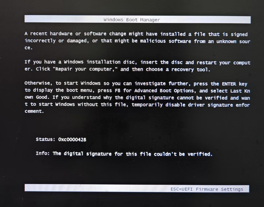

I tried to use Windows Server 2022 on X4, but it didn’t start successfully,

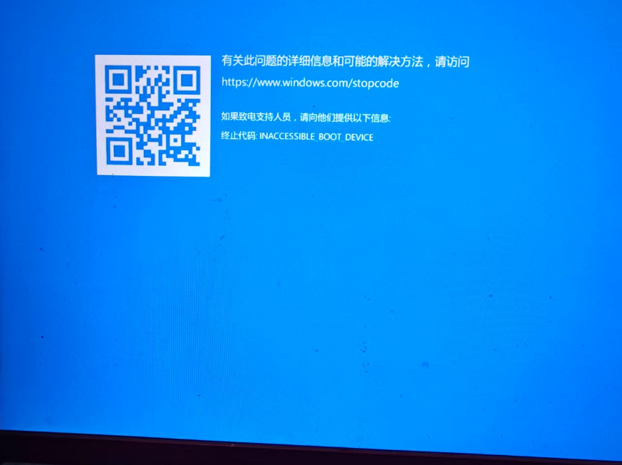

Then I tried Windows Server 2019 again, but still couldn’t start
According to other posts, Windows Server 2022 should working on x4
Looking at your error message, can you try to enter safe mode? Or disable driver signature enforcement
windows server 2022开机启动就报错0xc0000428,无法进入启动选项
windows server 2019开机可以选择启动选项,试用了安全模式和禁用驱动签名,都终止在INACCESSIBLE_BOOT_DEVICE
是否用的微软官方网站下载的server2022,最新版本?安装到emmc还是ssd?制作安装盘的方式也有影响
另外安装windows11正常吗?
微软官方网站下载的server2022,安装在emmc,制作安装盘是参照说明书制作的
试试ventoy,另外试试ssd排除是否与emmc相关
