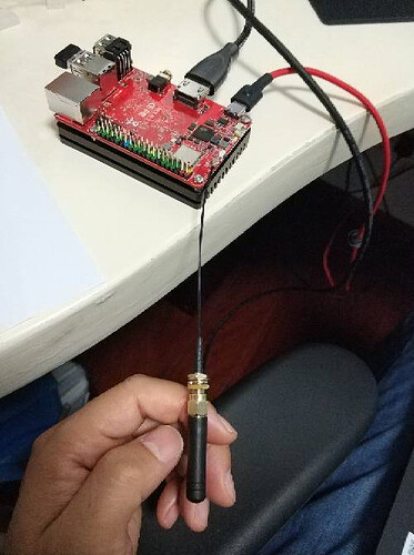

I had find this device ,but driver not work , find better driver

There is not any problem with the Radxa OEM Windows… but installing a fresh W’10 I can’t use my WiFi. I installed the Radxa drivers but it doesn’t work ![]()

Only way to make it work is to use the OEM Windows image you find on the wiki as far as I know. It comes with the drivers pre-installed. As everything with this board, it’s a mess. One of the driver included is a HP printer for some reason.
Also don’t expect support from the Radxa team. They gave up on support for this board.
