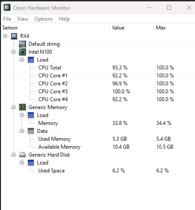

i actually tried the offiicial and 3rd party way to show temps… i cant seem to find the temp readings anywhere… on other PCs and SBCs … they just show right away… here is a screenshot I have using openhardwaremonitor …
Please try aida64 or hwinfo or coretemp

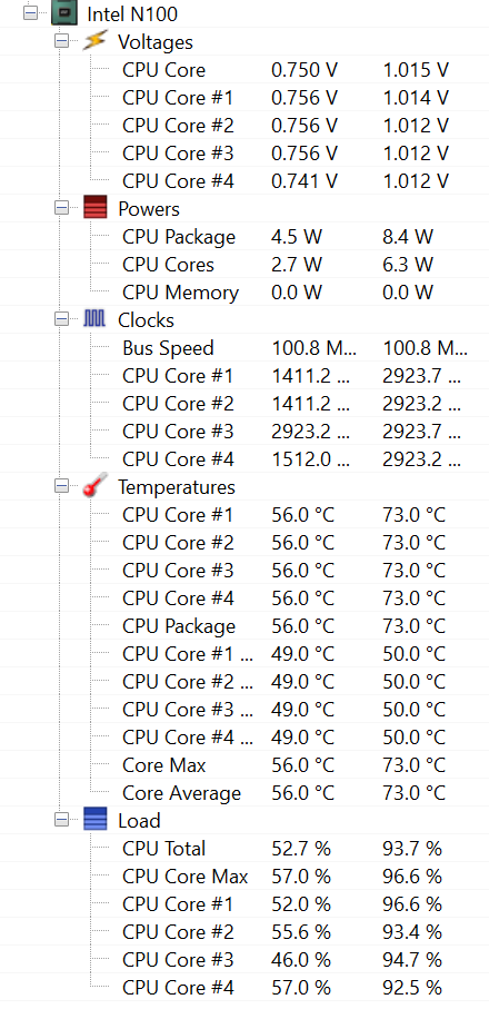

Here is LibreHardwareMonitor on mine - I think OpenHardwareMonitor is no longer under development, Libre is a fork still actively developed.
