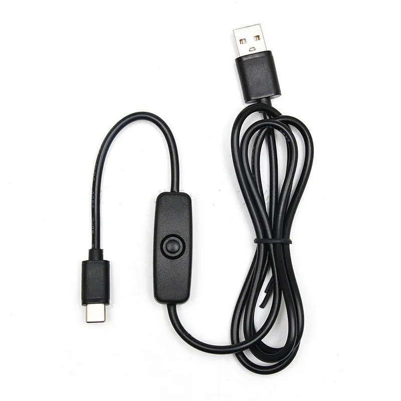

Here is what you need.
3A USB Type C Cable for Samsung S10 S9 S8 Huawei P30 Pro Fast Charge Type-C Phone Charging Wire USB C Cable With ON OFF Switch
https://a.aliexpress.com/_mt4bMVz
