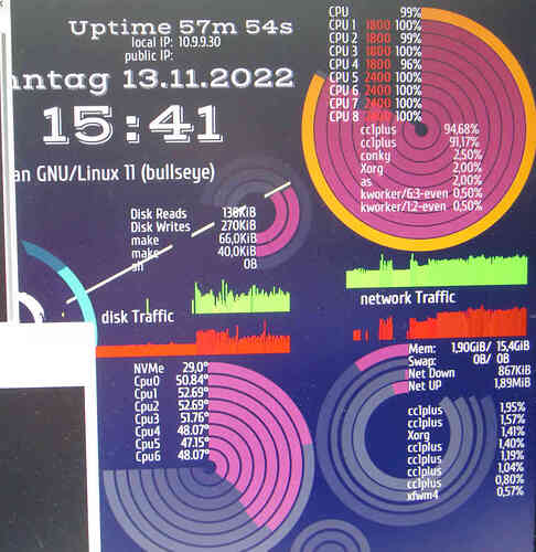

I run a compile job on all cores and using default blue heatsink temperature rised until 84°
Is this a safe temperature or should I add some fan ?

Add a fan, yes.

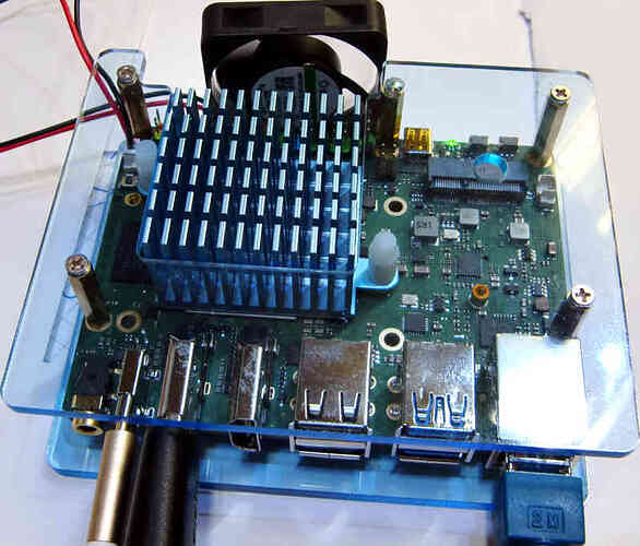

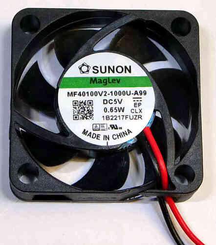

I have put a small Sunon on the heat sink. Connected to the 5V of the GPIO pins. At 12V the Sunon is already very quiet, at 5V inaudible.
Although the fan only blows topdown the temperature stays below 60° at the same load.
I think this is healthier for the professor.

With aspect to fan-voltage: you could use a fan built for 5V, than pwm should work.

I moved the fan from topdown blowing to blowing from backside to front.
That way I could lower the temperature even more and nvme which was at 55° before stays now below 35° constantly.

I bought a 5V fan:
In case someone is interested in fan-control software, where temperature/fan profiles could be changed without recompiling software: my repo
I think fan should go on left hand side as you can blow right accross the length of the board. If I had a case thinking a push and pull config accross there would make a great thermal solution.

I tested topdown blowing too. Keeps processor cool, but does not cool the nvme. A side blower keeps nmve cool as well.
