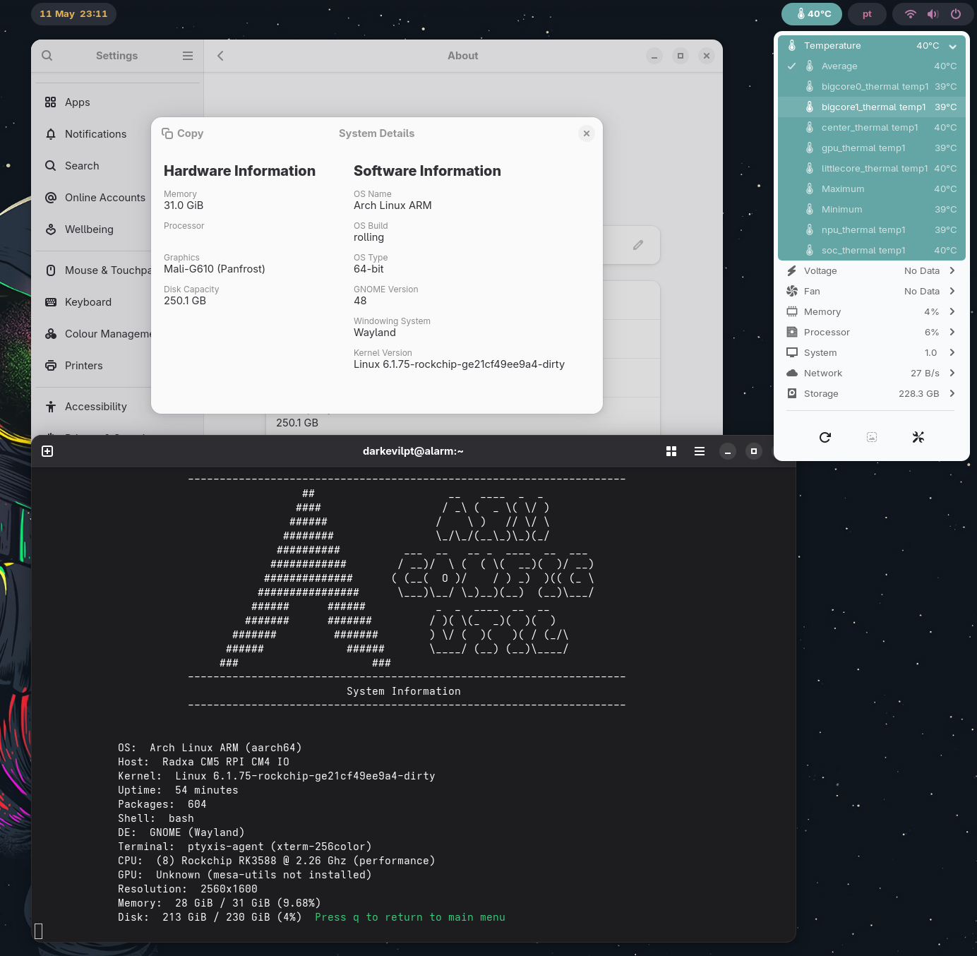

I want something like CM5 size capable of running LLMs. Waveshare CM4-NANO-A isn’t ideal for me, but it’s a good start. Since it doesn’t have video output or network connection, I need another board to set up CM5 module. I chose Waveshare Mini Base Board A, hoping it would make the transition to Nano Base Board easier. But it did not.
I need WiFi and Bluetooth, I bought an outdated Edimax EW-7611ULB V2, compiled the driver and worked fine on Mini Base Board A. After I moved the CM5 to Nano Base Board A, CM5 refused to boot, and turned too hot to touch within a few seconds.
