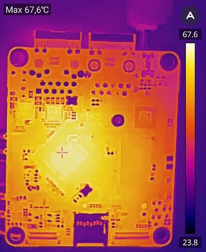

I tried to connect USB power meter, and while being in just a u-boot prompt, doing nothing, it sucks 5V 440ma. So, 2.2W while just doing nothing.
To me it looks like a hardware design issue. Or maybe my board is somehow faulty?
Are you using any other peripherals? Some power sources are enabled by default in U-Boot, which can increase power consumption. For example, on my side, when I connect an Ethernet cable, the power draw goes up.
No, no peripherals at all. Here is a thermal photo of a board just flashed and booted without anything connected:
Is there a way to reduce CPU temperature when peripherals are attached?
I currently have a PoE Ethernet and an NVMe SSD connected. I understand that these peripherals can increase CPU temperature slightly, but I’m consistently seeing CPU temperatures close to 90 °C on Debian.

Put a heatsink on that board I can see the allwinner stencil.
One thing to keep in mind is that most arm soc don’t throttle until they reach 70+, using heat sinks and or fan is recommended. Another thing to check is our power supply voltage with a multimeter or other inline tester. something like 40 at idle isn’t a big deal upgrade your cooling.
