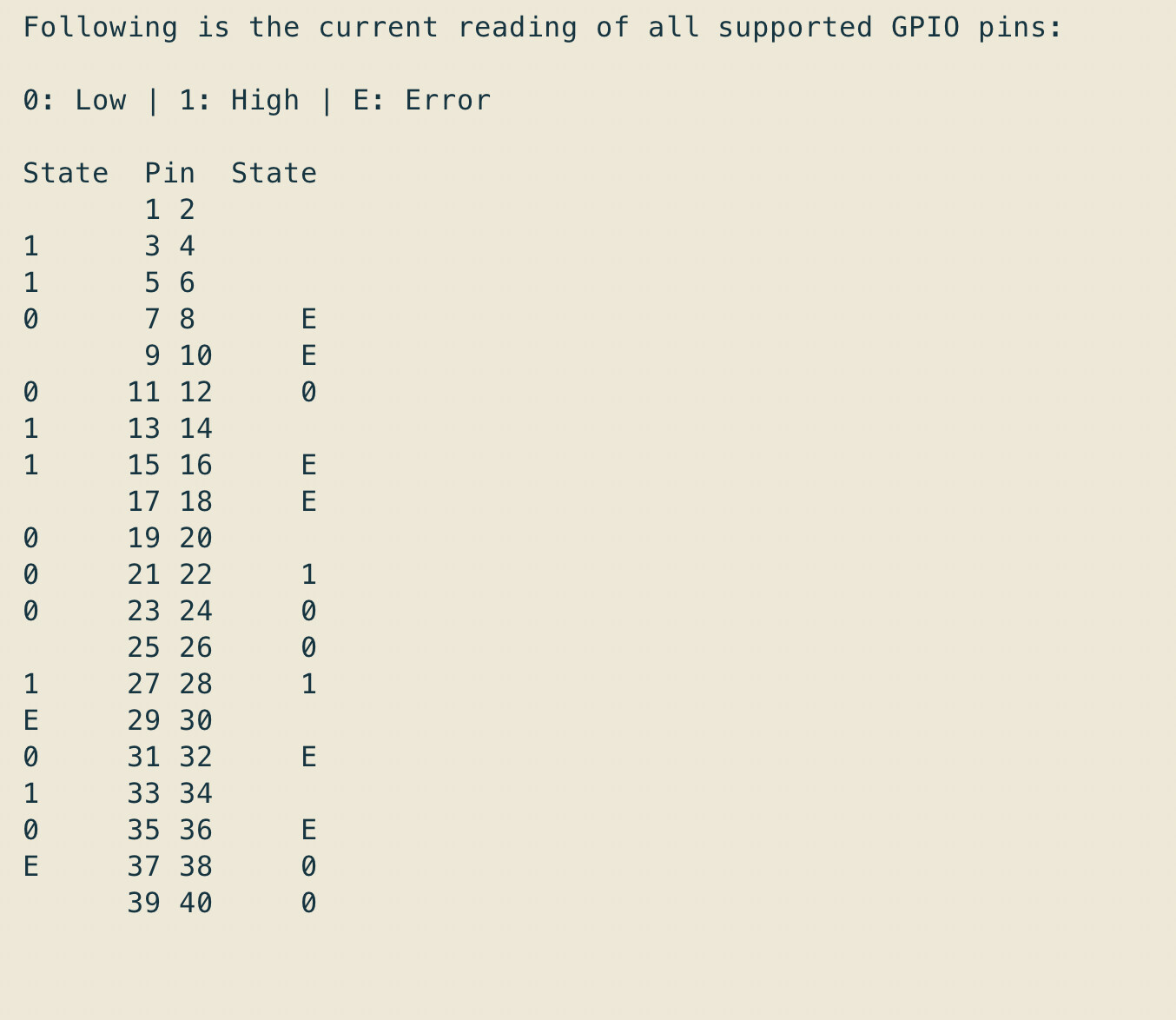

when i checked pin state via rsetup , they all show error. @martinw7750, are you able to use uart 6,7 or 14 ?
