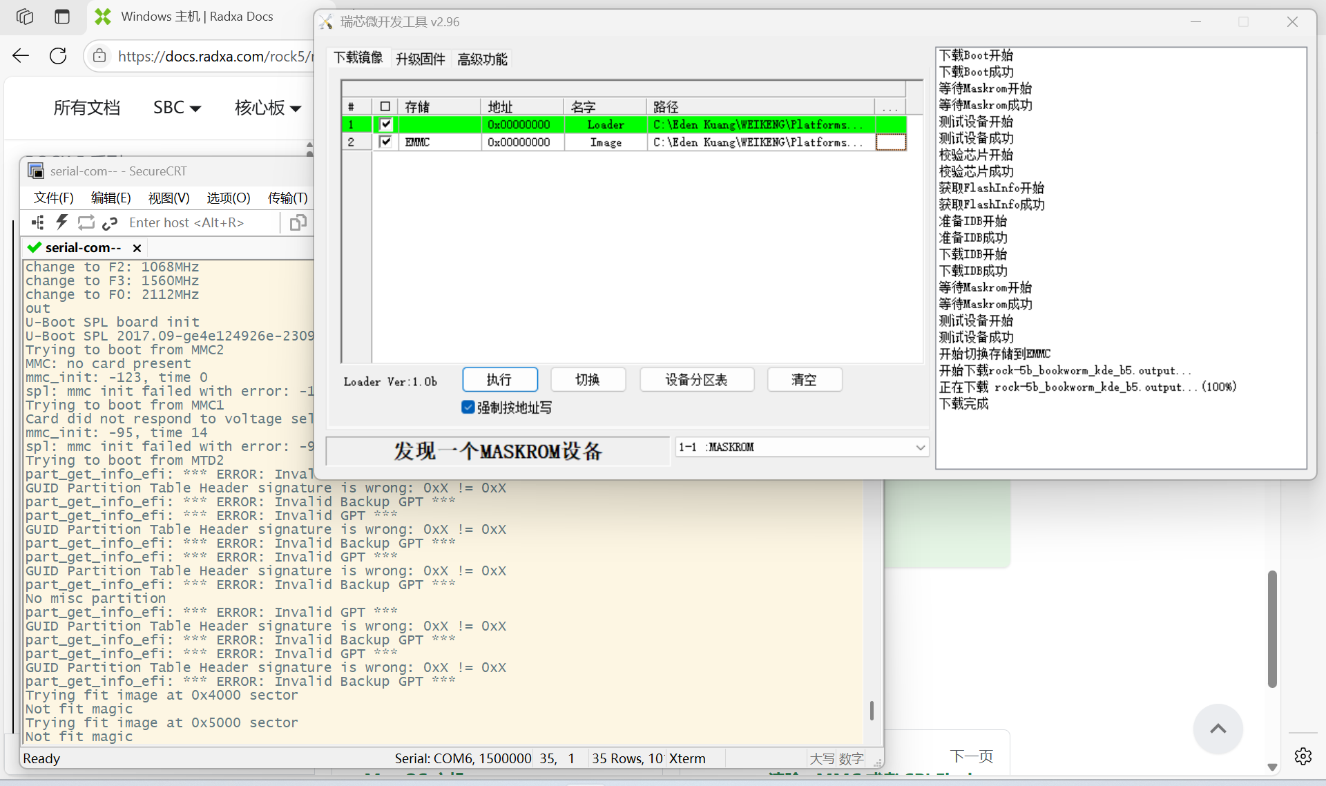

通过USB成功烧录img到EMMC,自动重启系统加载失败
按照以下方法成功通过US烧录img到EMMC,但重启失败,UART显示如下log
Windows 主机 | Radxa Docs
out
U-Boot SPL board init
U-Boot SPL 2017.09-ge4e124926e-230922 #lxh (Sep 25 2023 - 10:58:38), fwver: v1.13
Trying to boot from MMC2
MMC: no card present
mmc_init: -123, time 0
spl: mmc init failed with error: -123
Trying to boot from MMC1
Card did not respond to voltage select!
mmc_init: -95, time 14
spl: mmc init failed with error: -95
Trying to boot from MTD2
part_get_info_efi: *** ERROR: Invalid GPT ***
GUID Partition Table Header signature is wrong: 0xX != 0xX
part_get_info_efi: *** ERROR: Invalid Backup GPT ***
No misc partition
Trying fit image at 0x4000 sector
Not fit magic
Trying fit image at 0x5000 sector
Not fit magic
SPL: failed to boot from all boot devices
ERROR ### Please RESET the board
详细操作结果如上图
please try to erase the flash first
