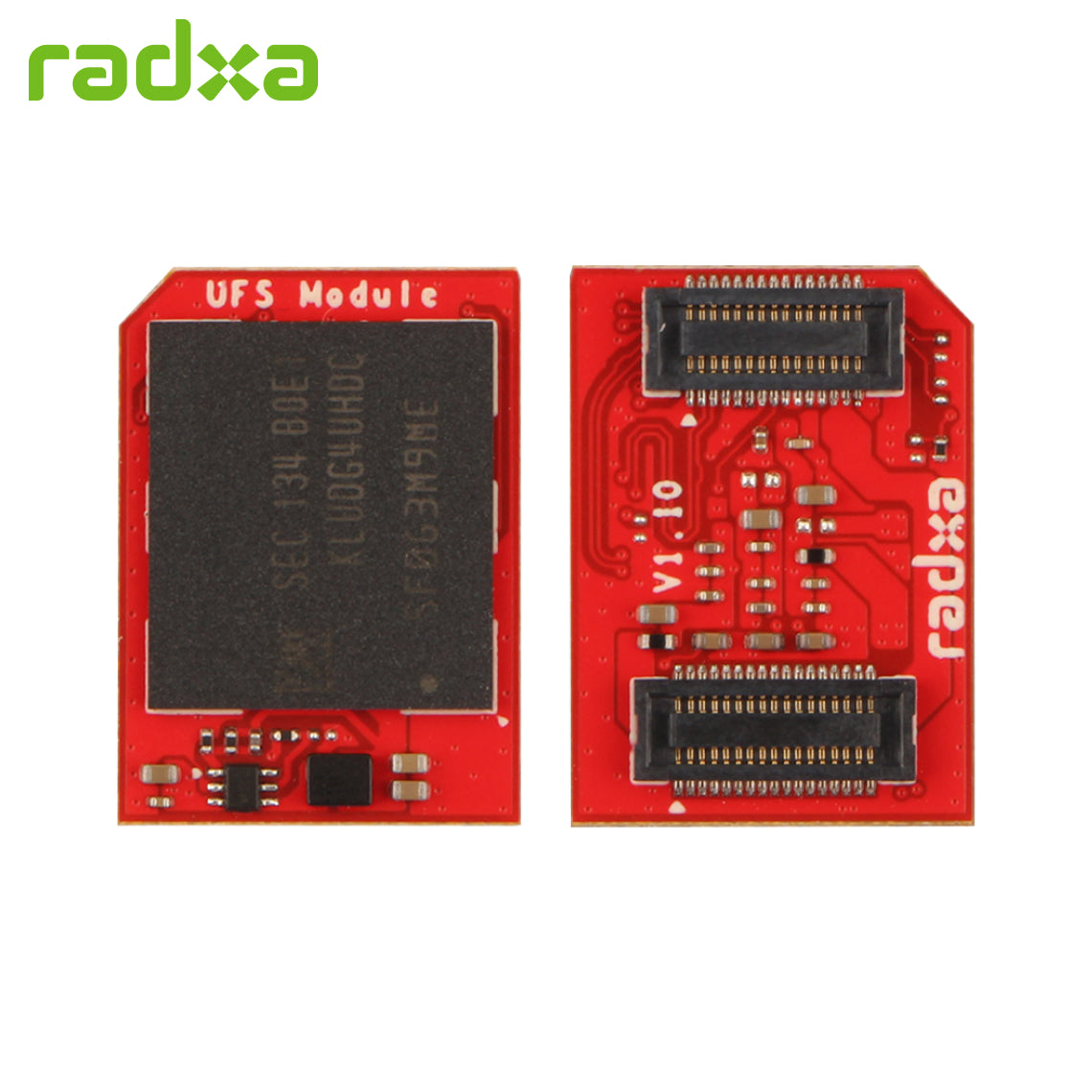

I have a Radxa Dragon Q6A with the Radxa 256GB UFS module (Kioxia THGJFGT1E45BAILB).
It is powered by a Radxa DC12 36W power adapter via the 3-pin connector, but I’ve tried a USB-C PD adapter too. It has a 13mm all-copper heatsink with fan that keeps it cool (less than 60 °C in stress test)
I flashed the radxa-dragon-q6a_noble_gnome_r2.output_512.img.xz image on a USB, booted and then downloaded and flashed radxa-dragon-q6a_noble_gnome_r2.output_4096.img.xz on UFS.
The system boots up fine from UFS but after a while it gets stuck or reboots randomly!
I stress tested CPU and memory with stress-ng and they are fine.
Running fio to test UFS (when booted from USB), and using dmesg -w, I see lots of ufshcd-qcom errors, mostly PM and hibern8 issues. Also, instead of 1811/557 MB/s (specs for Radxa OS using UFS module Kioxia THGJFGT1E45BAILB), fio reports ~60 MB/s R/W !!
It doesn’t look like a hardware issue, more like a UFS driver issue, but like many linux drivers there isn’t a separate loadable module, ufshcd‑qcom driver is compiled into the kernel.
uname -r shows that I’m running 6.18.2-3-qcom kernel.
I opted for UFS for better power efficiency and comparable speed to NVMe, and I’m very disappointed.
Has anyone faced similar issues?
