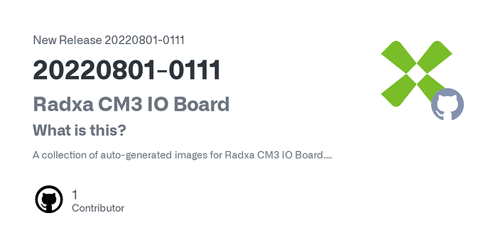

there are multple bsp’s and kernels
but i looked at and see the trouble :), the debian build repo has still the old precomiled packages so no wonder that you got a 2020 mpp userland
you can try a newer image the newer mpp are just added
so try
I upgrade CM3 to bullseye. And use mpi libraries that you point out.
mpi_dec_test -i h264.h264 -w 10 -h 10 -o aa
it worked. Thanks.
